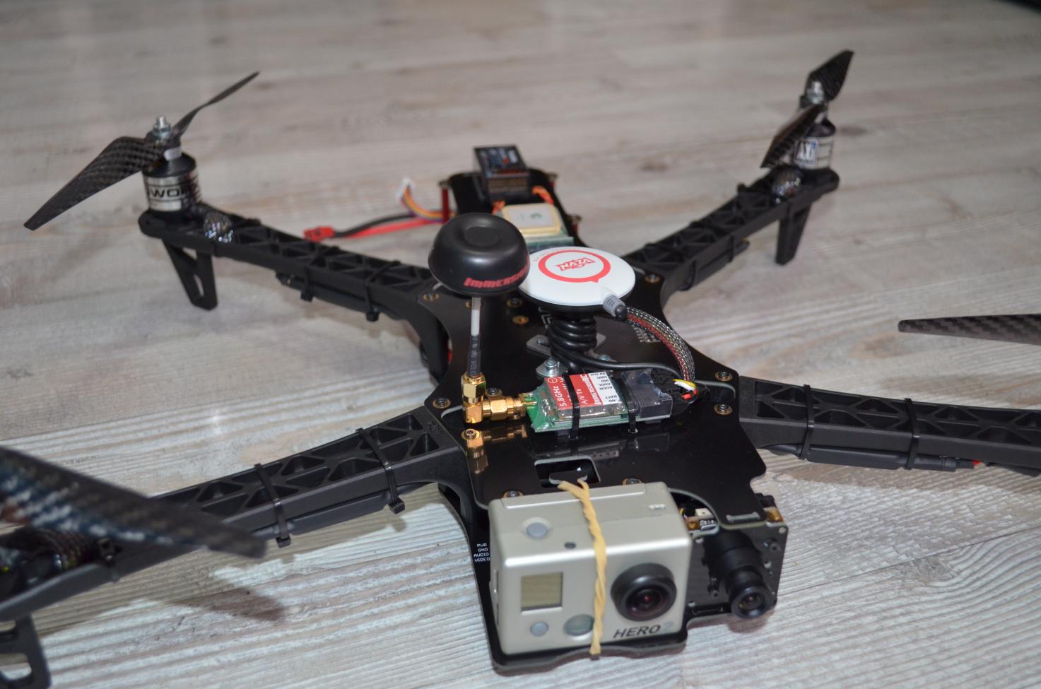

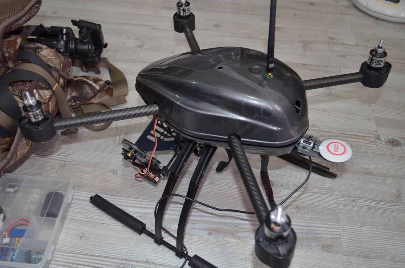

Try it on an Arm, or cut that fiberglass dowel to keep it lower ... have a look at mine.
View attachment 11283 View attachment 11284
The arrow on the GPS has to be facing fowards and moved to the correct directon a few degrees, to avoid any Toilet Bowel Effect issues when in GPS mode.
You can read more about that in the manual.

Yeah if it is upside down won't it switch left and right? If you still have the GPS unit facing upwards you can have it where you want with appropriate adjustments in assistant.
I have my GPS module mounted in typical location with Velcro on the module itself. Makes for easy removal and adjustment for magnetic declination.

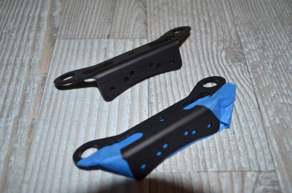

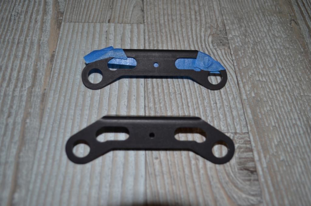

Yeah, the GPS needs to be mounted the correct way up. One thing I did with my fiberglass pole, was to crimp the aluminum mounts to the pole. This allows me to move the gps for declination, and remove it if need be, it does not vibrate loose or anything.... worked out pretty well for me. Some have Velcro'ed them to the top plate without a mount, some have used double sided pads, but it MUST be mounted and aligned correctly.

I like the idea of the crimping of the aluminum base. I'll try that. I also use a piece of velcro strap to wrap around the cord to the GPS and the GPS shaft that takes the slack out of the cord and so that in itself puts a downward pressure on the shaft to keep it from hopping out.
