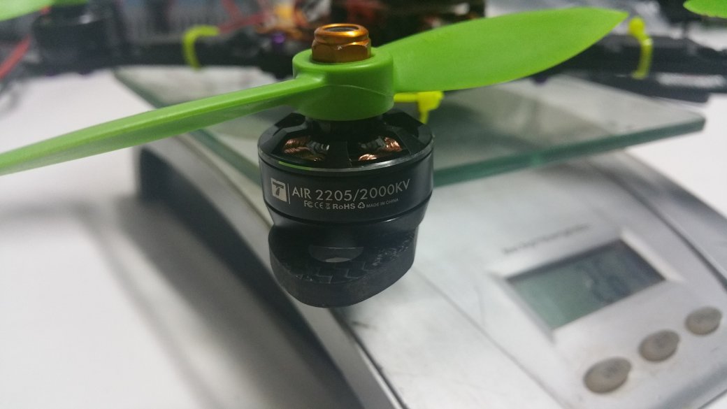

When I assembled the larger rig I had one motor slow to start regardless of what esc it was connected to. I have seen this before, and busted out the lc meter, pulled the bell off the stator and took some readings. Sure enough it had a slight short across 2 of the phases. 10 minutes of flying and the smoke came pouring out. Motor done. I spoke to ready made rc and they were happy to issue an RMA for inspection but living in Canada shipping is more than the damn part. I ended up just ordering a complete new set.

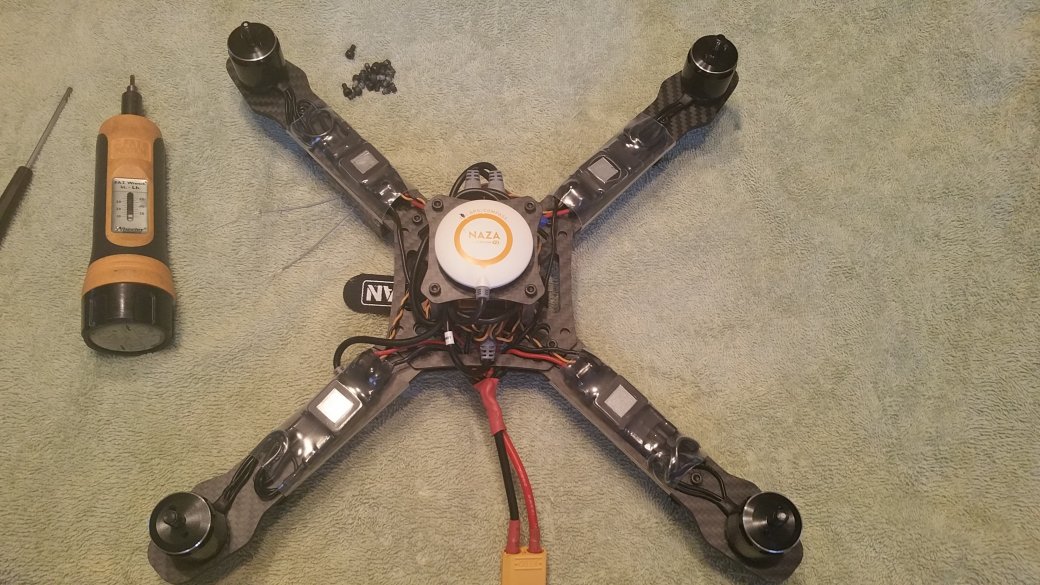

Here is the rig. View attachment 26378

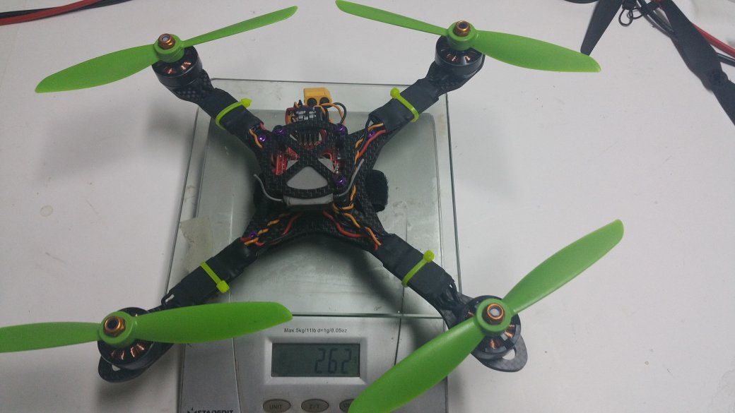

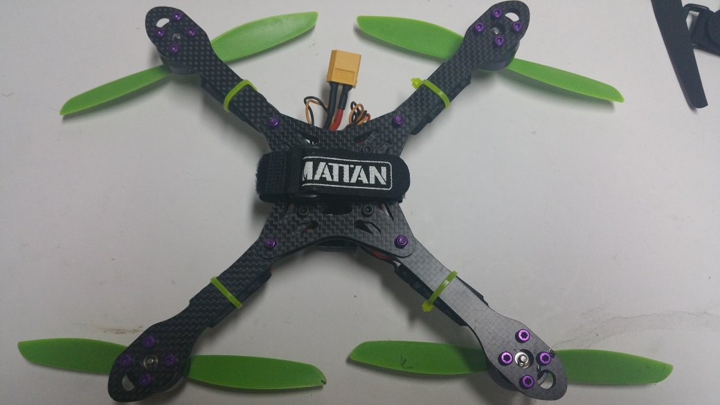

First time with a naze but I got her flying real nice. After 5 or 6 packs I adjusted the settings and started to play with rolls. 50' up, my first full roll and when she tries to recover one motor stops and she drops like rock. View attachment 26379View attachment 26380View attachment 26381

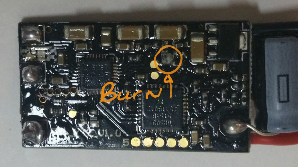

Esc fried. you can barely see the burn mark in this pic. View attachment 26384
The scary thing is that the air gear 200 set originally came with air 10 amp esc's and they switched over to 15 amp, which I have. obviously 10 amp wasn't enough for some applications and it appears the 15 amp isn't either. I am gonna get rid of these air esc's completely and try the ZTW spider mini 18A (because I can get them locally)
