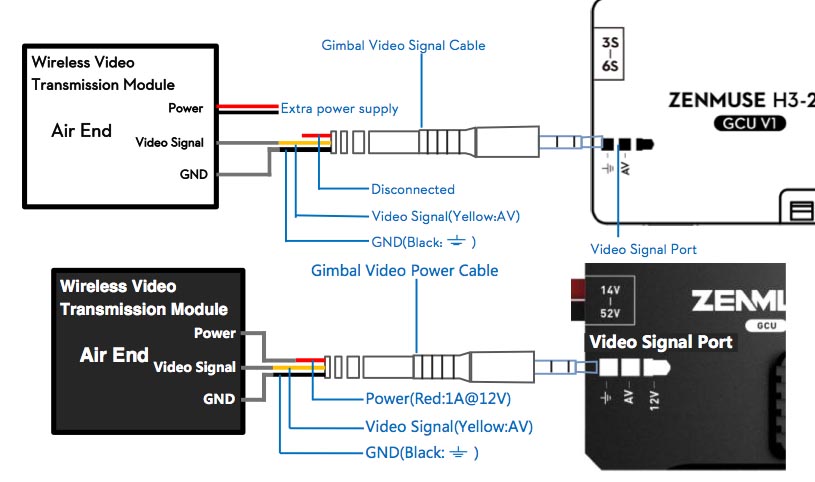

Second question is is there a difference in the video out cable from the Z15 and the H3-2D? I'd like to just use the same video TX between the two.

Z15 has video plus power on the video cable, the H3 does not
So the H3 needs its own power supply. We used a small 3S Lipo. You could also take off from a BEC.
