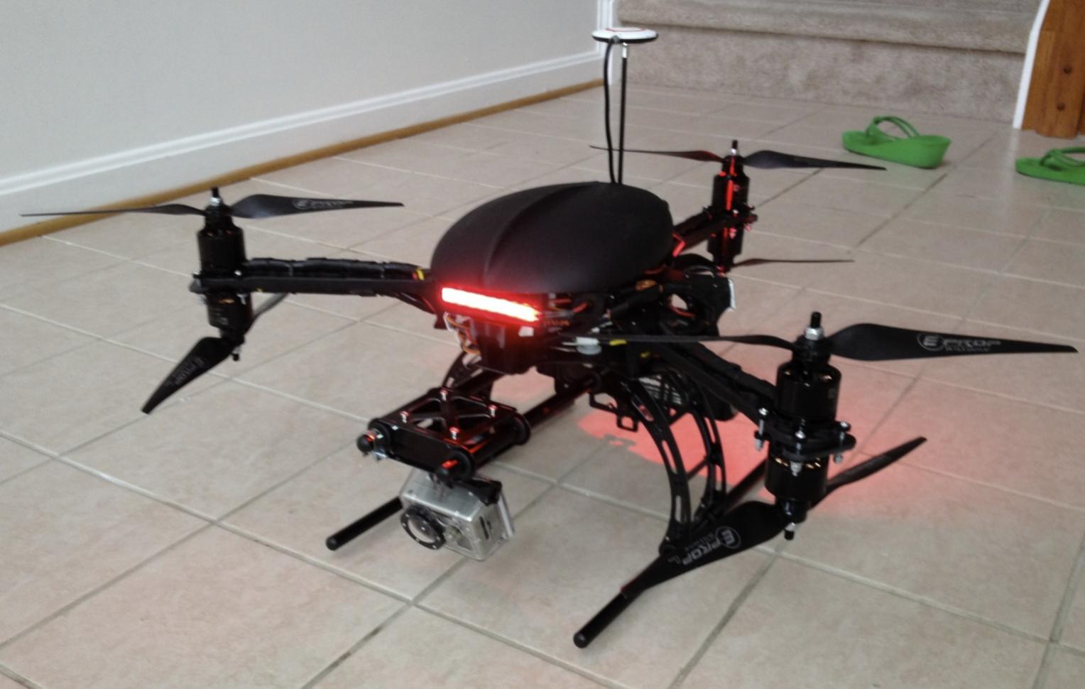

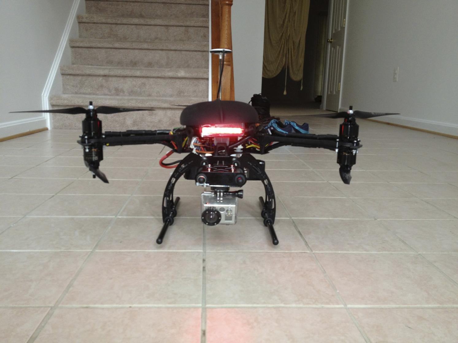

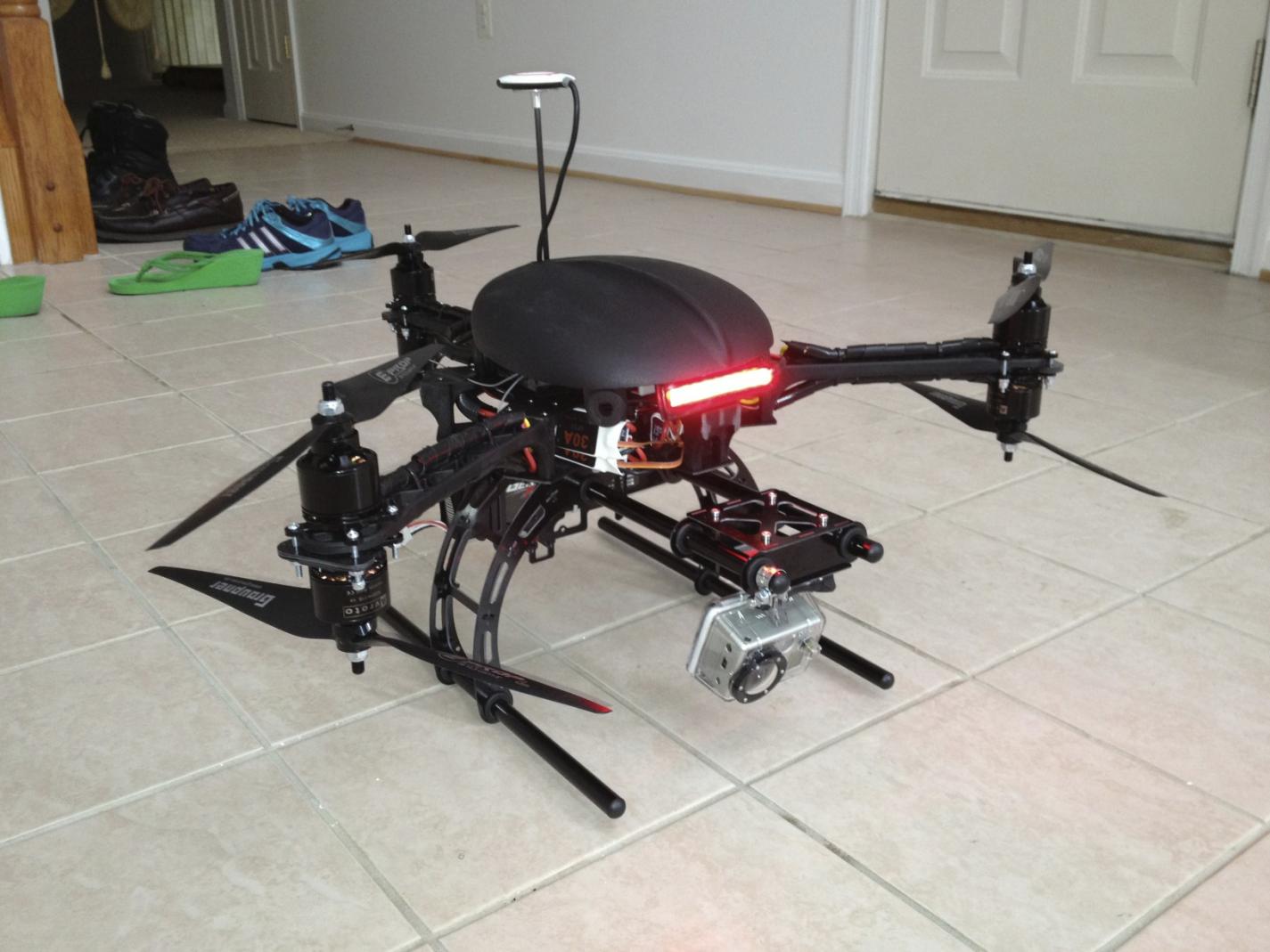

I just finished a Y6 build with Avroto 2814/11s. I use 30 amp DJI esc and the copter weighs approximately 6 pounds. It will be close to 8 pounds once I get a light camera gimbal for my sony Nex 5n and FPV camera. I had these motors on a flat hexa and they performed flawlessly. I'm working on increasing flight time with the Y6 configuration (setting the battery voltage protection etc and experimenting with flight times vs parallel batteries). I like the color of the motors and the length of wire that they come with. View attachment 6035View attachment 6036View attachment 6037
As shown:
DJI F550 converted to Y6
Avroto 2814/11s
DJI 30amp ESC
Genesis 3s 6000 mah lipo battery (experimenting with flight times (may get 4s batteries)).
Aeroxcraft landing gear (such a brilliant design) mounted in plus configuration for Y6
XAircraft canopy shell - I love that look vs. a dome.
12 volt water resistant LEDs (eyes). I ordered "regular" LED, but the company sent me the upgrade.... hmmm?
11x5 Graupner blades - Excellent prop that actually provided 13 seconds more flight time vs. 10x4.7 APC props
I'm still trying to maximize flight time without burning up my 30amp ESC while maintaining 8 pounds or less on AUW. (suggestions would be appreciated...).
Anyway.. This is the second time that I purchased Avrotor Motors. I like the look. They run smooth and have plenty of power.

I just finished a Y6 build with Avroto 2814/11s. I use 30 amp DJI esc and the copter weighs approximately 6 pounds. It will be close to 8 pounds once I get a light camera gimbal for my sony Nex 5n and FPV camera. I had these motors on a flat hexa and they performed flawlessly. I'm working on increasing flight time with the Y6 configuration (setting the battery voltage protection etc and experimenting with flight times vs parallel batteries). I like the color of the motors and the length of wire that they come with. View attachment 7996View attachment 7997View attachment 7998
As shown:
Avroto 2814/11s
DJI 30amp ESC
