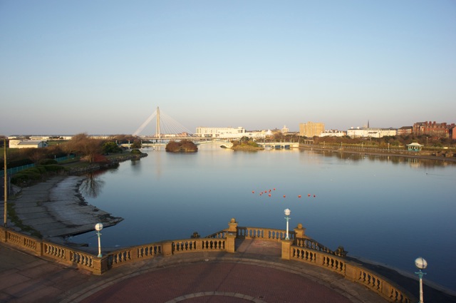

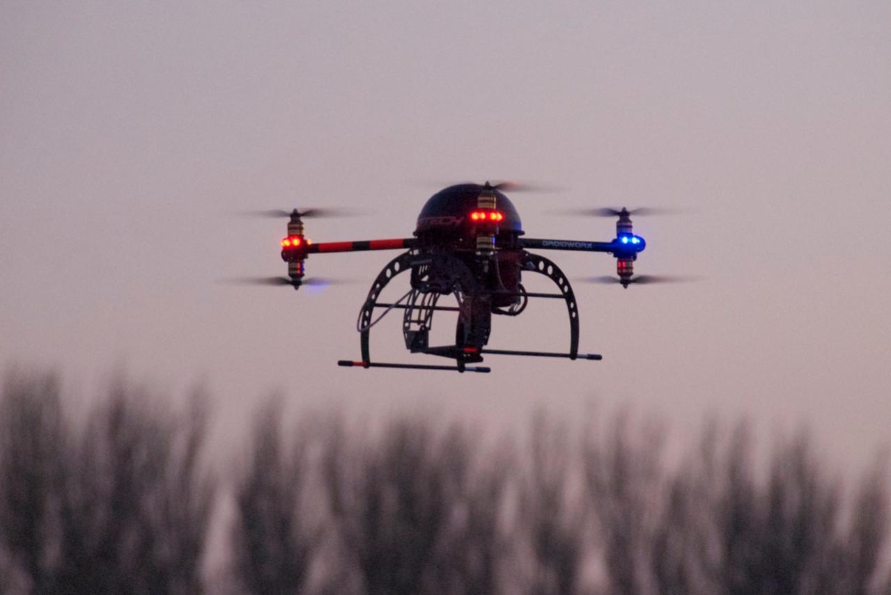

Lessons learned today
Ok heres what I learned...
If you are using blue tooth telemetry on the MK to scope the flight DO NOT have the GPS screen up in MK tools.. It seriously sends the mk into fits as soon as you hit the GPS hold.
I was lucky to survive the wild dance the MK performs.. I intially thought something had gone seriousley wrong with the MK flight board but then realised it was the nav board as when I turned off GPS hold I could fly as normal. It was only when I did my last flight thinking I had a serious issue that I remembered something I had read about the Nav board to make sure the compass board is proerley secured to the nav board. On removal of the painted dome I saw a red and green light on the nav board. Summats up err I thought. So went to MK tools which I had running on my laptop. as soon as I closed the GPS screen the red light went off and she flew perfect and GPS hold was rock solid again...
SO
Lesson one. Dont use the GPS screen in the MK Tools to monitor GSP signals when you are flying with blue tooth modules.
Lesson two. Dont paint your dome so you cannot see the various status lights on the flight controller, nav board and gps board
Best think I found out how to do this weekend
Lesson three . DO USE the micro sim to record your flight from the nav board. Its an invaluable tool for analysing everything from tx/rx max / min signal, battery info, max amps.. just about everything, even max stick movement, speed, altitude, GSP positions, everything..
I recently found another reason to go along with this, to be able to see if any of the magic smoke is escaping...:eek:
