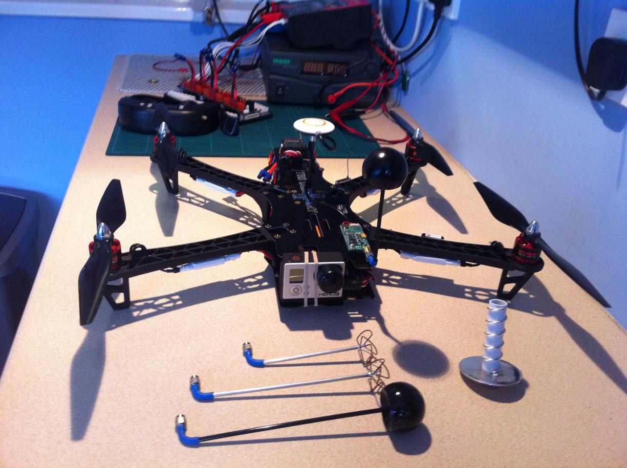

Hey Pete, nice bit of fly there mate, like the flying between the goal posts, weather here has been total pants in the UK and I've been grounded for the last week because of high winds, ho-hum... Flight packs are Turnigy 3s 5000mAh, I get about 12 mins of FPV flying with 25% still in hand, which suits me fine. As said in my original post all gains are at factory which is 100% at the mo. A couple of pic's of my Disco and my own antenna including my new "Black Rod" antenna that I've been working on (making gig-a-wave antenna is my day job) View attachment 13626View attachment 13627

In previous life I did my training as a "Radio Mechanic" then as an Electronics Technician but these days they think I am a Network Engineer but I have always enjoyed tinkering with small electronics/electrical gear and would love more details of your antennae!
