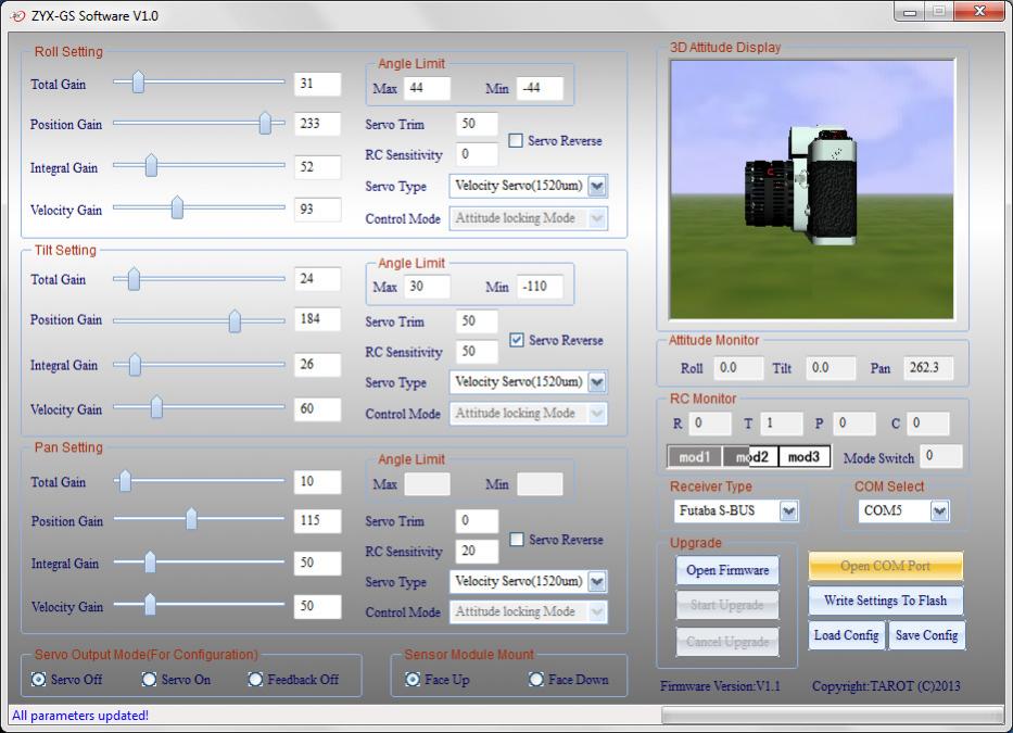

jhardway
here's what I am running at, it seems to work pretty good for me, over all I feel its a good start for any one working with it, during set up if the tilt go to far the unit will shut itself down, so it will not damage or burn out any servos. I spent about three hours getting it to a point where it ended it up working well.
cheers
hope it helps View attachment 12758
