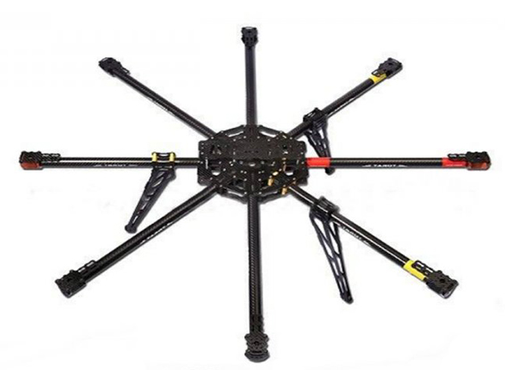

As i am happy with my DJI Naza f450 I now want to add no more to it and go to a Tarot T1000 frame,
now some of u may say i am crazy especially being a bit of a newbie but i have done a bit of research and i think i have it mostly thought out. If anyone has attempted to build it pleas your advice is welcome
I will start with cheaper parts first not A grade parts.
I almost wanted to build a hex but i knew i would just want a OCTO so why build a hex i guess.
Purpose: Becasue its a bigger copter . and i want to lift a DSLR Camera but i am happy with a go pro for now
Tarot MAN T1000 Frame
Naza V2 + gps
Futaba 10j Transmitter
S6 Zippy Battery not sure how big yet
Gimbal: Gopro Two-axis Brushless Gimbal/With Gyro
Now for the more critical components
Motor: 4114-320KV Turnigy Multistar Multi-Rotor Motor With 3.5mm Bullet Connector
PROPs: 1555 Carbon Fiber Propellers CW and CCW Rotation with Dual Mountings
ESC: Turnigy Multistar 45 Amp Multi-rotor Brushless ESC 2-6S (OPTO)
Now i this is a cheap combination but i am not 100% if it s compatible combination. I am more worried about the Motors and ESC because its aftermarket. I have read about issues with esc and havent really found a BEST combination so i just want get some advice on who has done this and what did they use.
