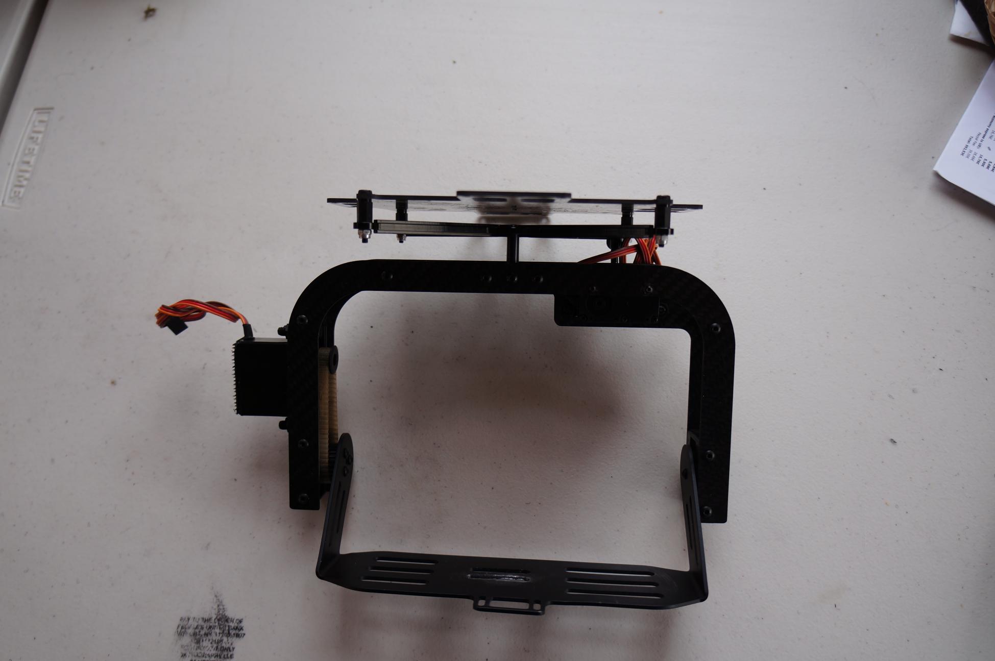

The Tarot 680 Fly's very well, it is stable and really stay put where ever I want it. The down side is the legs, these broke on one hard landing (read crash). Instead of ordering new replacement parts I just ordered CF tubbing and cut this to length for the vertical leg stands and also for the horizontal landing skids. This is held to gather by a simple pipe T Joint which works well. Also in doing this I was able to increase the distance of the ground clearance to provide enough space for the Photohigher Gimbal.
