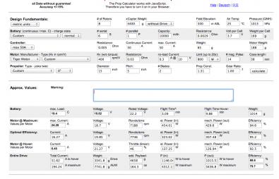

Okay, lets see the options:
These figures are for MT3520 (KV400). This is very similar to MN 4014 400KV in terms of efficiency and performance.
* Weight without components (Only frame, gimbal and camera) is 4400 grams. I'm sure it will be less.
So with 6S and 15x5 props, we will hover around %50 throttle, which is nice. If you have a lighter payload, you can either switch the propeller to 14x4.5 or use 5S Lipo. Changing prop is more reasonable when the costs are considered.
MT2826 can be overpowered with 6S, it's good for 5S if we look at the figures. MN4014 or MT3520 is good to go. Don't forget to buy spare bearings, at least 4 sets.

Thanks heaps for doing that. What calculator do you use for this?
You don't happen to have a higher res image of the above by any chance do you? its a little hard to read.
You mention the MT3520, are you meaning the MT3515? They have a AT3520 for airplanes.
