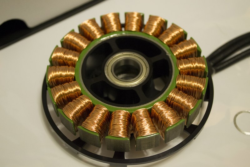

You should not judge a book by its cover so I definitely had to take the motor apart to see what’s inside. Items found inside – a thick (17mm) shaft and some blue material that is used to balance the motor. It is good to know that the factory has paid attention to balancing the motor. I found three different spots that had the blue balancing material. On Figure 6 and 7 You can see that the shaft is bolted tight with three bolts. When I say tight, I really mean tight – it took two grown man to disassemble the motor. The three bolts that hold the shaft are locked in place with thread locker. Due to the magnetic field it is also quite a hussle to separate the top and bottom part of the motor. The details of the motor are up to the T-Motor standard. On Figure 7 it is shown that the three wires that come out of the motor are fixed with heat-shrink and hot glue so You cannot break them too easily. I would also like to point out that this is the first brushless motor that I have come across that has motor wires pre-wrapped in mesh-guard. It’s also important to note that motor wires are 150 mm long and very stiff. There are two different prop adapters included (with bolts). The center diameter of one adapter is 8 mm and the other is 10 mm (Figure 9).
Figure 5. The motor has been pre-balanced by the factory.
Figure 6. The shaft of U13 (diameter 17mm)
Figure 7. Bottom side of the motor.
Figure 8. Stator of U13.
