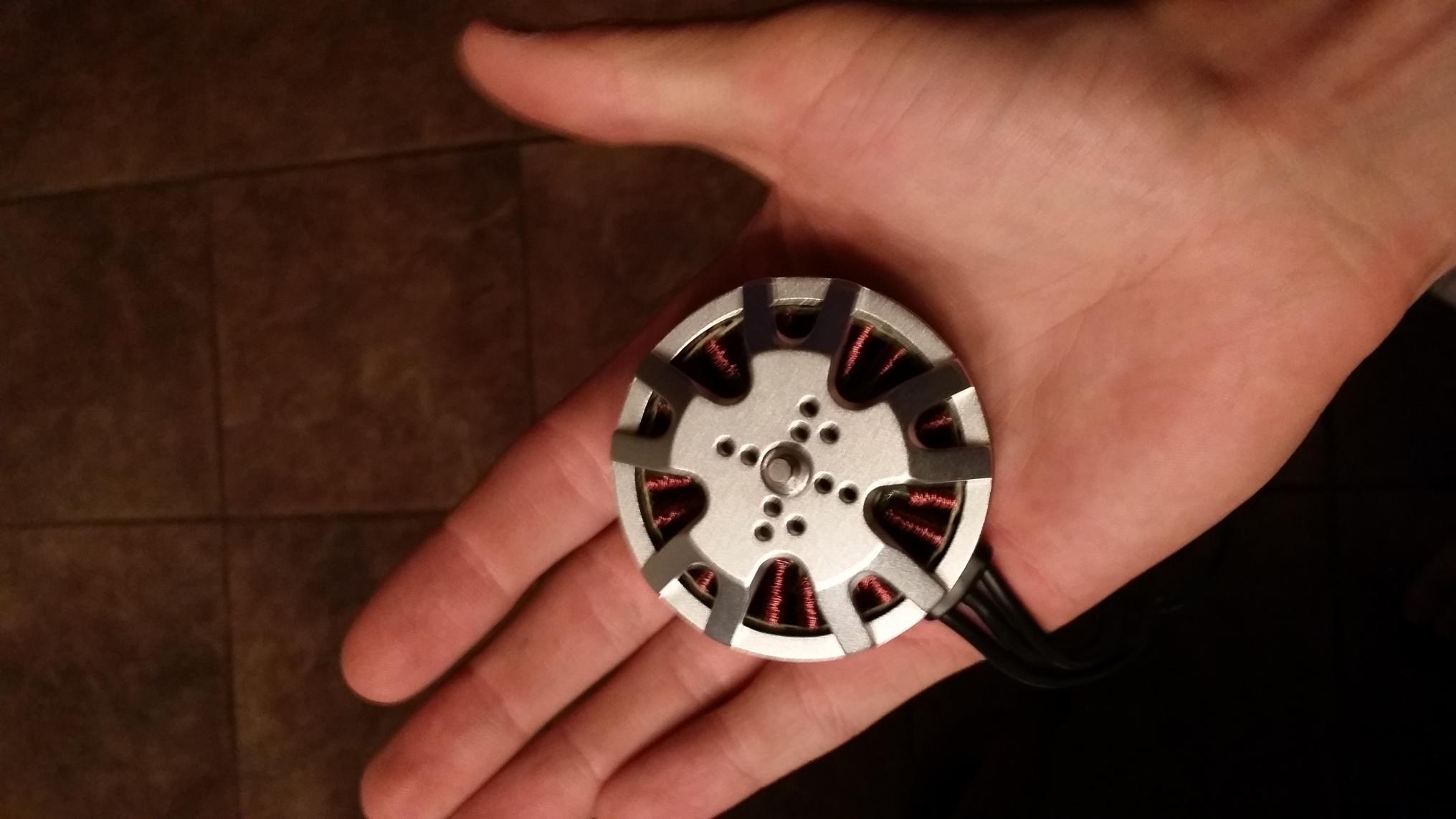

These motors are HUGE! I had to modify the motor mount slightly so the hole on the bottom would clear the screw that helps hold the shaft collar on. I don't have the large motor mounts for the frame since originally I was just using the 4014s.

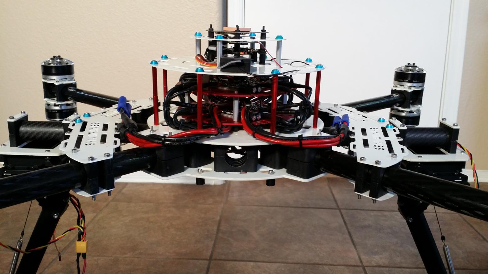

Because I am using 2 of the Herkules boards I have 4 power leads coming out of them. I only am flying with 2 batteries so I merged them together so I have the each battery power both boards. To do this I used 2x 5mm bullet connectors and soldered a power lead from each board into the LONG end. Then I soldered them together with a single wire coming out from the connectors and heatshrank it all together.
I stacked the boards ontop of each other and the way they are wired to the motors the top board powers all the top motors and the bottom powers the bottom motors. With the mixer setup If I loose one board inflight I loose the top or bottom motors and not 2 motors on one boom. I think with the total weight I will be flying it should fly on 4 motors! I will be testing this soon.
**Side note, Herkules does offer a Octo XL board which has 2 quad power boards mounted to one heatsink. Because I live in Phoenix and have to fly in really hot weather I opted for 2 Quadro XL boards so I had 2 heatsinks which will keep things cooler.

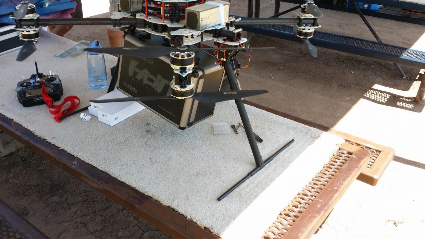

Here it is completed just before the maiden. I love how clean of a setup this is with the Herkules boards!

After that it was time for the maiden. The first flight I did without any payload. It was just the copter and 2x 10,000mAh 6s batteries from Tattu. Ambient outside temp was 100*F and around 50% humidity. I hovered around for a few minutes to ensure how it was flying. With the initial PID settings on the MK FC (P110, I120, D10, Gyro-Comp: 55, Gyro Stability 5) the copter was flying beautifully! I flew around for 15 1/2 minutes and used 17,000mAh out of the 20,000 total. Motors weren't any warmer then what they were just sitting in the sun before the flight and the Herkules boards never went above 50*C. This was mostly hovering around with a few, almost full throttle, climbs. This thing climbs like CRAZY!
attachment.php
After that test I decided to load it up with more weight then I would probably be flying. I added 16.5lbs of payload and took off. Total AUW was 34lbs with the 2x 10,000mAh 6s lipos. The way the payload was strapped on made the copter unbalanced, as you can see in the picture, and wasn't supported well so it swung around a lot. Because of this I only hovered and didn't do any movements. I stayed in a hover about 10ft off the ground for 5 1/2 minutes. There was no wind and no airflow over the motors or Herkules boards. Even at this weight and with the ambient temperature now around 105*F the Herkules boards didn't go above 80*C. This was only on 2 motors since it was off balance. The rest of them were around the 65*C mark with an average for all at 68*C! This made me VERY HAPPY as I haven't been able to fly anything heavy before without risking them overheating. Total current draw was 146-150amps
