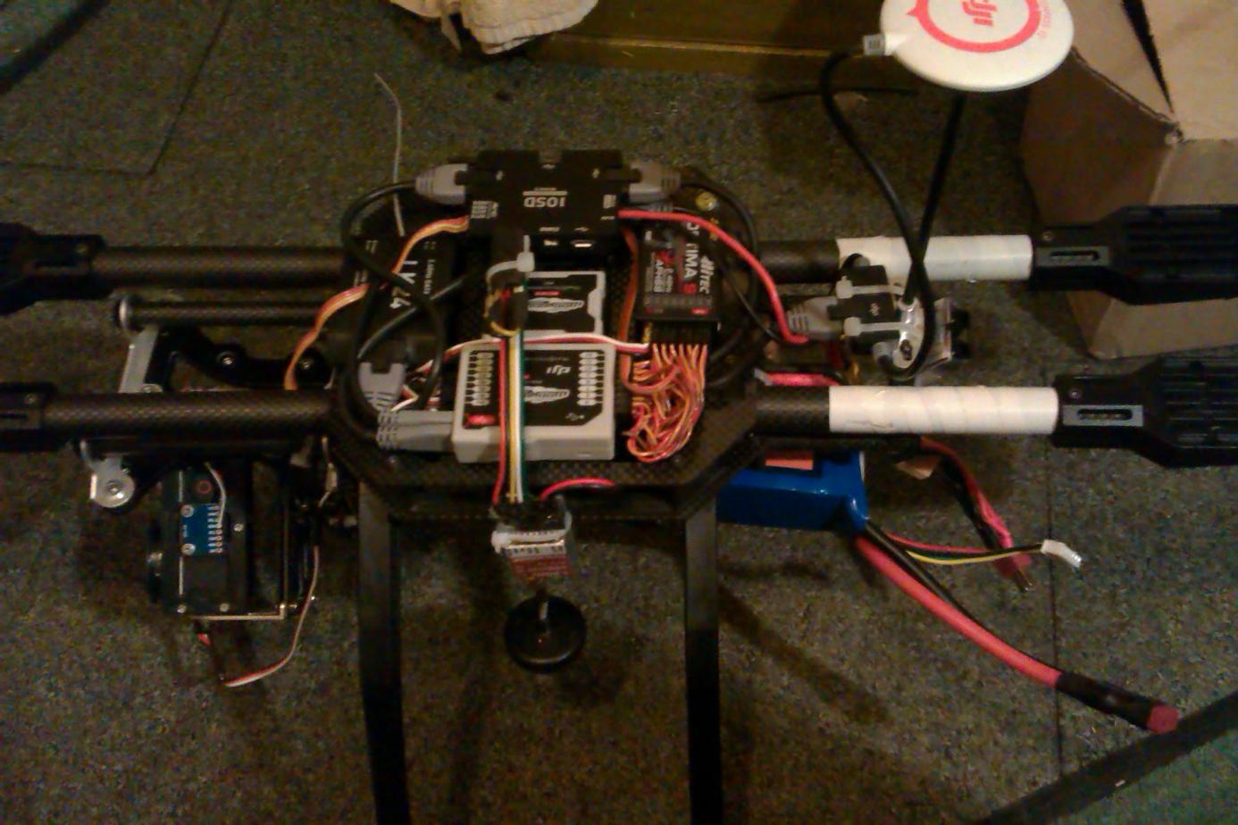

I have the pro version and simply mount it where they suggest and never had a problem. I have seen the disc mounted with no post in the same position which would be a lot saver for the puck in an accident but I keep mine on a 4" post at the rear. However, if the material used allows the signal through and you guard it with some copper foil I can see no reason for it not working under the cover. It would have to be on a post and not stuck to the underside of the cover because you will always be removing the cover between flights and to fold it.
Personally I have a lot of electronics in there so best kept away from it all.
