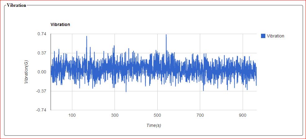

I can only assist in terms of a X650 Pro Quad, here is my BB vibration graph of a 16 minute flight, I think the mean is about 0.08g
