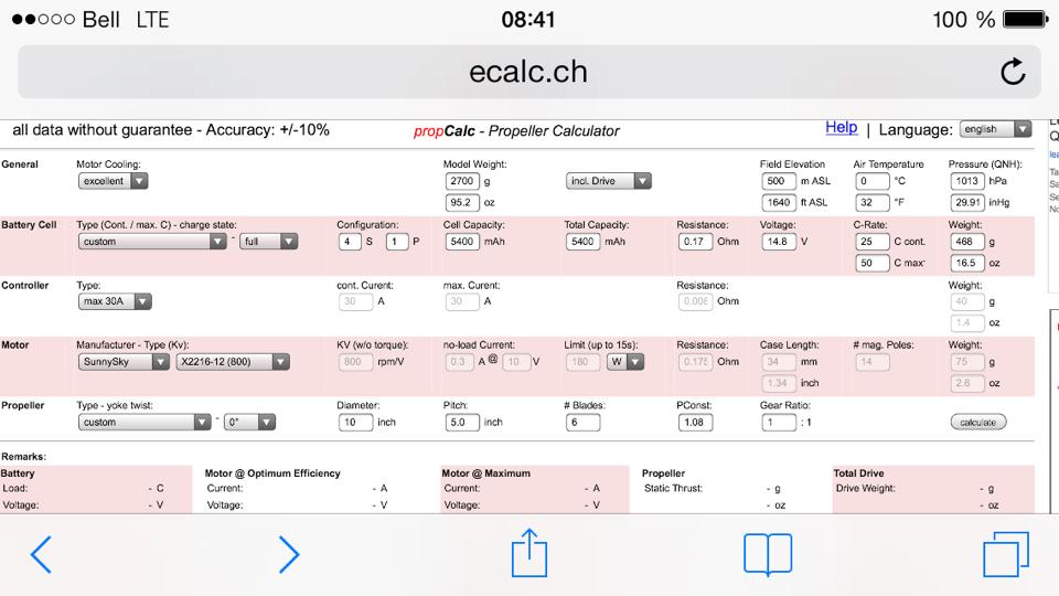

You can use ecalc. Google it. It will allow you to check the effectiveness of your set up. I personally fly my F550 with DJI 10x3.8 props on 4S 4000mAh. I like them and also use them on my F450 with H3-2D, iOSD mini and video down link, my favorite A/P platform. When I get the E300 propulsion system, I am going to try the 9" props. I am not sure if they will be any better but it is worth a try. The esc's look interesting.
Can you help? Doesn't work when I use custom battery
(ThunderPower 5400 mah 25/50 c burst
14.8v
How do I find out battery's resistance?
What is "P" in the battery section (next to cells)
And I'm not sure how to select to good prop
@juilien
This is your issue... You are pushing the limits on your current setup. The F550 will only allow you to run up to 10" props. The only prop that I have found to work on a 550 (6lb) w/ 800kv 2216 motors are the graupners 10x5. You could find a slow flyer prop but I think it might tax the motors to much. Just like you, I also fly in some cold temps, so you could probably get away with it until the warmer months.
