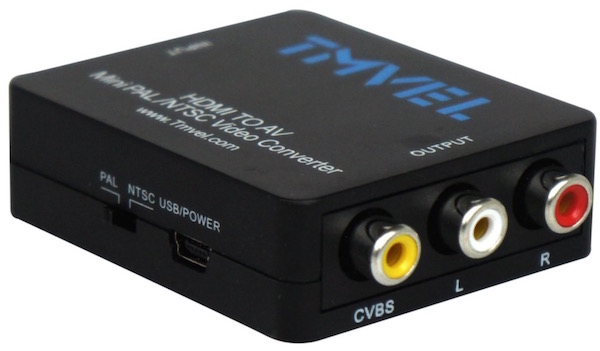

What I want now is an hdmi converter setup that is known to work. The only thing I see that is confirmed for NTSC because it has a switch is this one:
http://www.gothelirc.com/shopexd.asp?id=1977
But I would prefer something like this:
http://www.mobilexcopter.com/shop.htm#!/HDMI-AV-converter/p/40685370/category=3342127
I have seen video of this one being used and switching between PAL/NTSC on the camera but only non-US versions of the camera have that option. Does it work with a US version and switch automatically anway?
Any other suggestions?

That Helipal converter is basically this without the box.
http://amzn.com/B009CL8NH0
If you've got some heat shrink and can do some soldering you can save yourself some money.

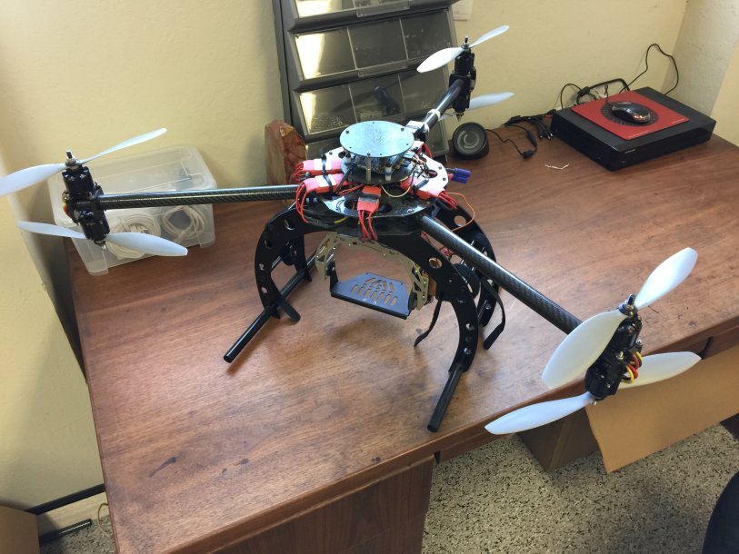

This is what I use for my GH4 and it works great, even in 4K.
