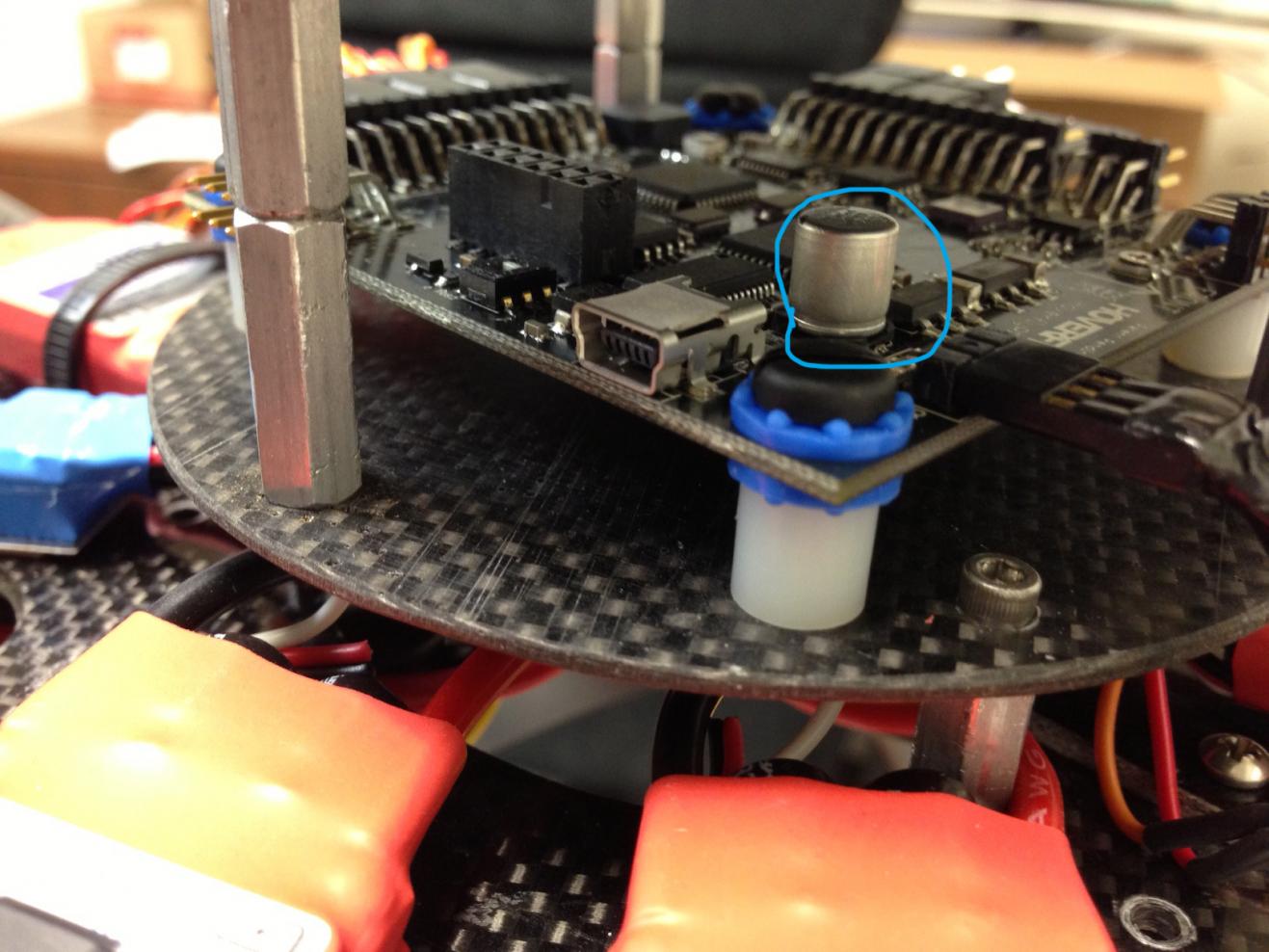

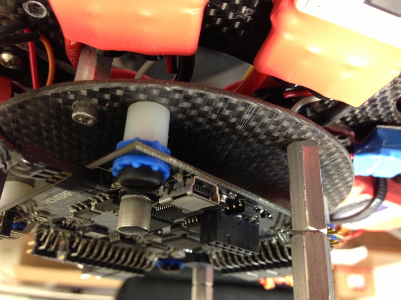

After a FPV crash a few weeks ago a small piece was loose on the HFP.
I resoldered it on.. It is a small round can looking thing on the front right side of the board.
I brought this little beater gopro only quad as a back up and for risky flights
Just finished a shoot and after alot of traveling and a flip in a heavy wind gust
the little can thing fell off the board.
I have no idea what it does. Is it essental to flight?
Have yet to try a flight with out it.
Thanks for any info.

Yeah, I can blow that up.
Have a picture of the board sans "can"? It's probably a capacitor. If it is, you should be able to replace it with a similar valued one. I would image it's required for good flight performance. I'm assuming its a filtering cap. (George?)

S11D336B
George - Hoverfly
That is part of the onboard power filter. If it's damaged it could be the cause of your flip. You may want to use an LC filter from dpcav.com on the HoverflyPro's power input if that part is damaged.
