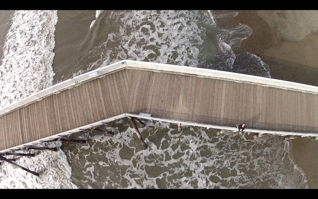

Some of my first AP shots
tombrown1
Just some flying around and practice shots. Taken with my extended F550 and nex5n camera. About half the pics I take are blurry, working on reducing vibrations.
Suggestions/tips appreciated.
View attachment 11705View attachment 11706View attachment 11707View attachment 11708

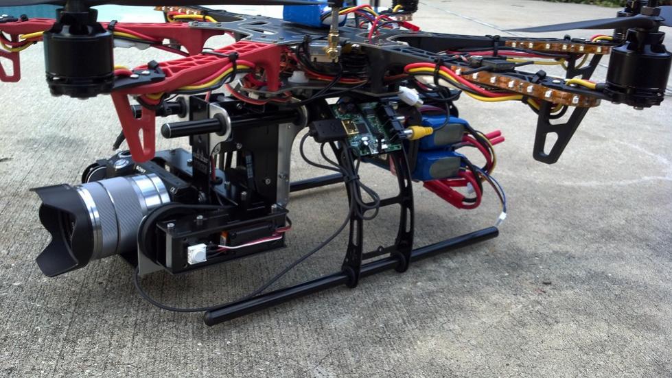

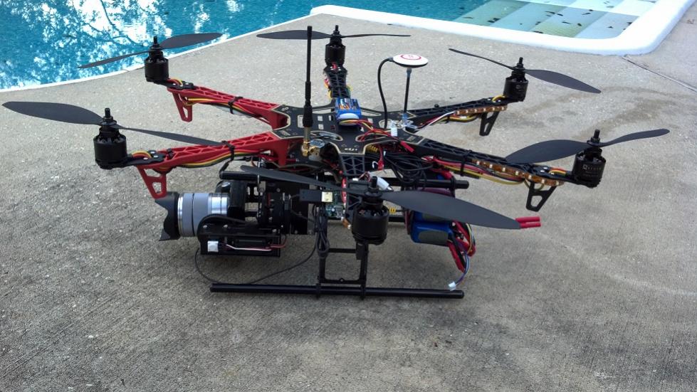

My hex:
F550 frame, extended arms and avroto motors.
11x7SlowFly props.
AeroXcraft landing gear and VTR125 gimbal.
2x5000mAh 4s packs
Nex-5n with hdmi/AVI converter going to a 2.4 vTx
Dragonlink RX

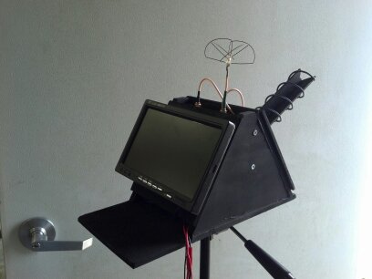

About 9min flights, here's an older pic of it, some things have changed. The ground station for the video is new, and works really good.

Looks like a pretty heavy lens. Do you have any trouble lifting all that stuff? Intelligent auto might work, but I generally don't really like the "auto" settings. The brain in the camera doesn't really know what you are attempting so will make decisions based on some algorithm that may or may not actually apply to your specific shooting conditions. What you want to do is maximize shutter speed in an attempt to eliminate visible motion blur. I shoot canon and don't really know Sony yet. I suppose that it might be possible in one or more of the Auto modes to tell the camera that you don't want the it to reduce the shutter speed below a certain point until the aperture is wide open and the ISO has reached some pre-set maximum. Probably easier to just set aperture wide open at the highest ISO that you feel will still give a level of noise that you can accept.

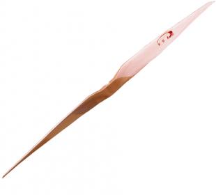

Thanks for the info on your platform. Are the large slow props supposed to reduce vibration?
Slow Fly props have wider blades, so they push more air. More lift.. Also, It's what I've found works best on my hex for stability, I tested a few different props on it.
Kilby
Try moving your camera a little more towards the center if the craft. It's sitting right in the prop wash, so it's really easy to get blurred shots that way. Its the same as someone constantly pushing or tapping on the camera while you are in the air.
HPL
Is Slow Fly a brand? Did you start with a Kit or just a frame? Do Slow Fly props turn slower and if so do they take a special motor? (Sorry for all the questions, but you are basically flying what I am looking at (Sony NEX 7 probably with the Carl Zeiss 24mm).
Slow Fly is a type of prop, with wider blades. APC is the brand I use. Be sure to get good props as we have allot of money hanging from them, and 1 bad prop will take it all down.
