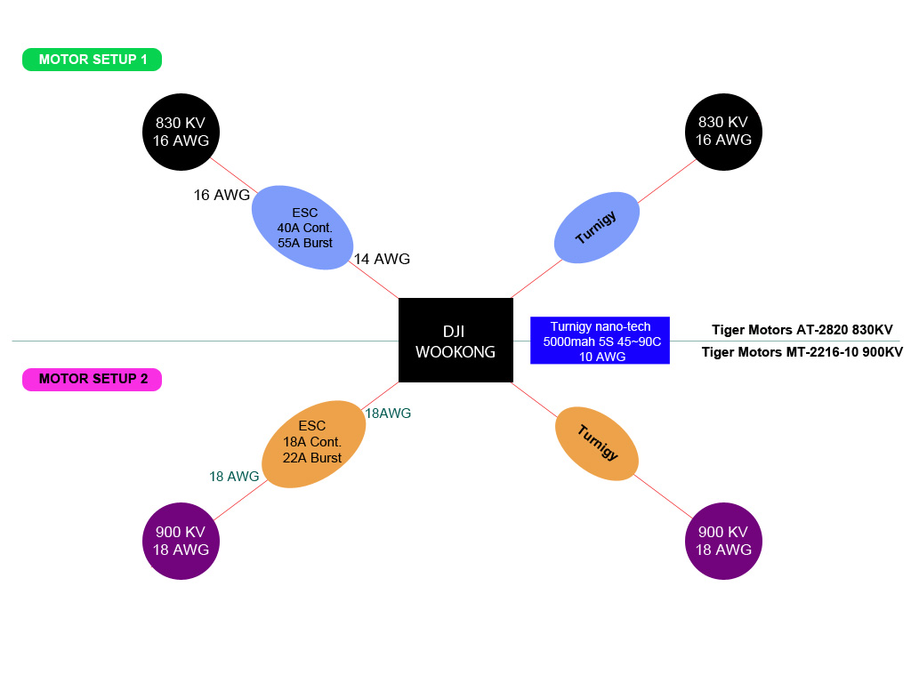

I just got all my parts and need to go get the basics. Please check out my setup below as I need your helpful recommendations on solder, soldering iron, and gauge wire.

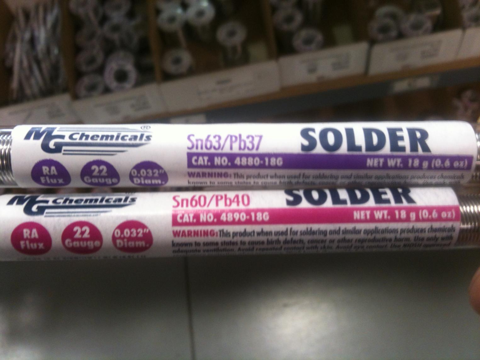

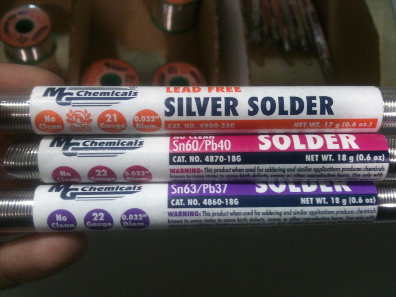

Could you guys recommend:
1) Soldering iron: 20A, 30A, or 40A ? flat tip or pointy tip?
2) Solder: ?? (confused salesman was no help) I am guessing I need 60/40 with flux.
3) can I use one gauge wire for the both motor setups?
3a) Wire Gauge - Motor Setup A:
3b) Wire Gauge - Motor Setup B:

40W iron (you can never have too much power, unless you're doing SMD perhaps). Interchangeable tips is a great idea - get at least small pointy one and one blunt (screwdriver) one.
Regular 60/40 solder - the "exotics" are trickier to solder with. The "no clean" flux is a good idea but "best practice" is to use a proprietary flux cleaner (usually an aerosol with a brush nozzle) after soldering.
Use the heavier gauge wire for both setups - if the wire never feels hot after flying a full pack, you could save a tiny amount of weight by going down a size.
