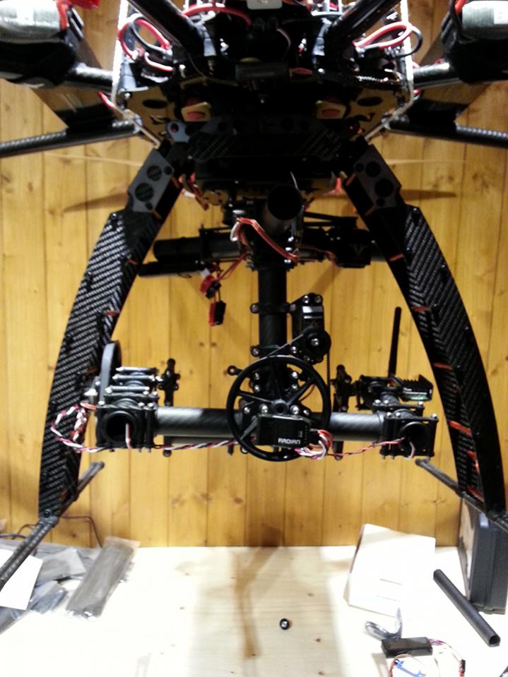

Okay, I am probably doing something really bone here. I am trying to fit a Cinestar 3 axis gimbal under a Skyjib v2 with the retractable landing gear. The problem is that the gear seems far to narrow when down and the gimbal just simply doesn't fit between the legs. Any ideas anyone?

We have a cinestar 3 under a skyjib V2 without retracts. We just use the three carbon legs that attach to the cinestar. Using retracts just complicates the whole system. It works really well.
Carapau
That's certainly a good solution however I am building this for someone and so was just wanting to make sure that I am not missing something here. Having been in touch with Allied Drones who supplied the adaptor plate (awesome service from them by the way) they too think that the legs are very tight on this specific configuration. I looks like I haven't done anything wrong but I would love to hear from any others with a similar issue.
Have you emailed Tom at DW?
As RTRPTL says why complicate the build with more kit than required.
