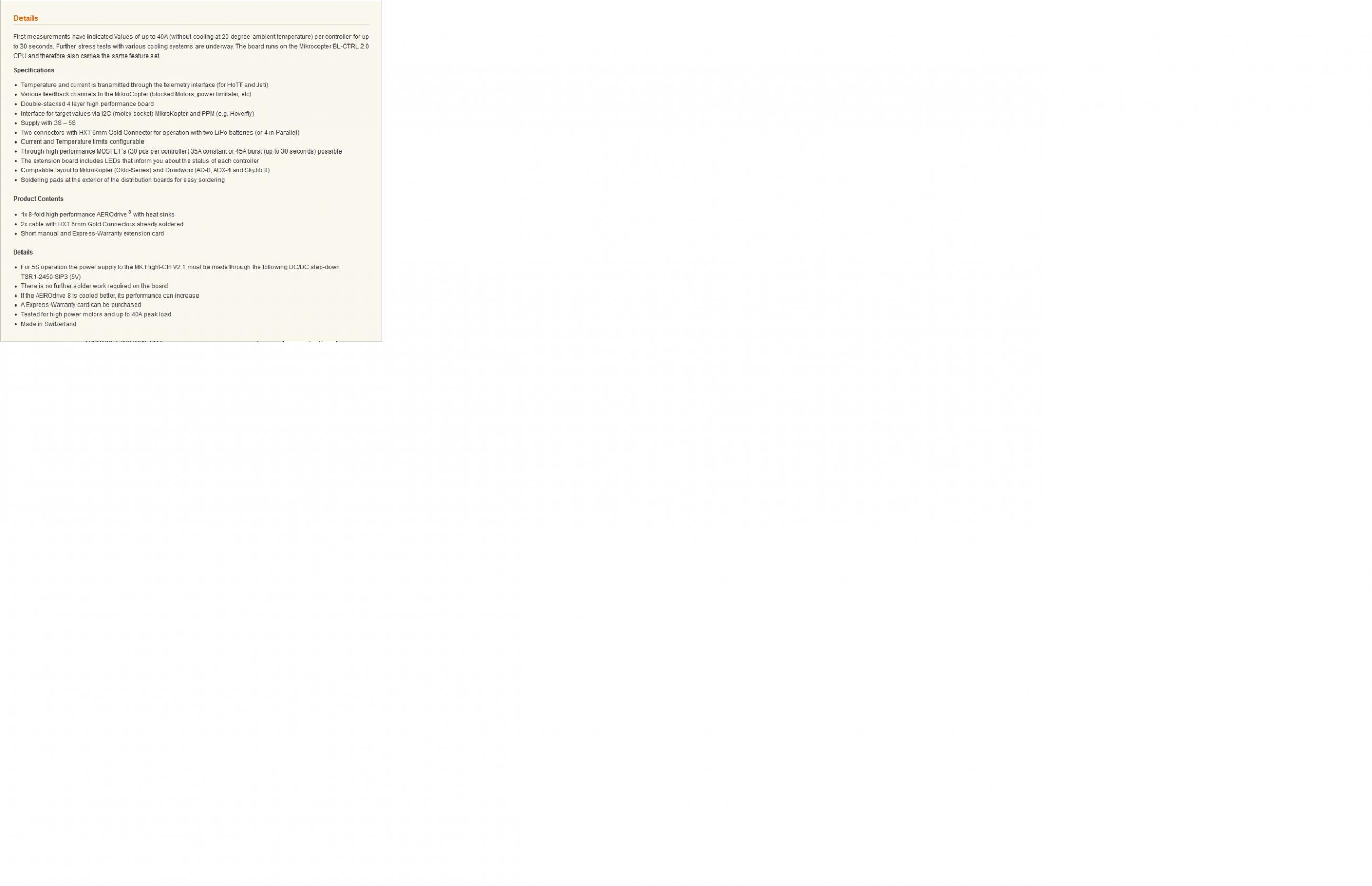

Well, AEROdron sent a reply this morning. Here it is with my remarks in red....for what it's worth.
Still no explanation of how to connect and talk to the AEROdrive 8 or exactly what the LED flashes mean. They still say the unit uses the MK software but states it's a 40 amp controller with burst to 45amps, yet the MK software is default to 35amps...
Details
First measurements have indicated Values of up to 40A (without cooling at 20 degree ambient temperature) per controller for up to 30 seconds. Further stress tests with various cooling systems are underway. The board runs on the Mikrocopter BL-CTRL 2.0 CPU and therefore also carries the same feature set. Specifications
  • Temperature and current is transmitted through the telemetry interface (for HoTT and Jeti)
  • Various feedback channels to the MikroCopter (blocked Motors, power limitater, etc)
  • Double-stacked 4 layer high performance board
  • Interface for target values via I2C (molex socket) MikroKopter and PPM (e.g. Hoverfly)
  • Supply with 3S – 5S
  • Two connectors with HXT 6mm Gold Connector for operation with two LiPo batteries (or 4 in Parallel)
  • Current and Temperature limits configurable
  • Through high performance MOSFET’s (30 pcs per controller) 35A constant or 45A burst (up to 30 seconds) possible
  • The extension board includes LEDs that inform you about the status of each controller
  • Compatible layout to MikroKopter (Okto-Series) and Droidworx (AD-8, ADX-4 and SkyJib 8)
  • Soldering pads at the exterior of the distribution boards for easy soldering

We have calculated your configuration. The slider is about 60, this is far beyond our statements to the AERO drive. We indicate 40A! That's correct based on what is NOW published. At the time of purchase, we only had the videos to go by. They showed similar configs flying with 14 and 15 inch props that were NOT identified as having modified software settings.
Calculate you can this itself under www.ecalc.ch
So the problem is obviously pretty clear the MosFET not go along with this. This is not a guarantee. You can send us the Board and we can fix it you after a cost accounting. Cost Accounting, are you suggesting that I PAY to have the AEROdrive 8 repaired? A failure that was the result of following vendors recommendations at the time... That's NOT going to happen. I will keep the damaged AEROdrive 8 unit and continue to post on the forums until you do what is right, and Cost Account the repairs to AEROdron for misleading marketing efforts. I followed recommendations as they were presented by the testers and vendors, I will not pay for repairs. If anything, AEROdron should not only cover the repairs but include a new set of landing gear tubes for the retracts that were bent in the crash.
As you can see, the problem is not the AERO drive, but your configuration. I hope you will clarify this in the Forum. I absolutely agree that it is the configuration! A configuration that was recommended by the Beta Testers and vendors such as yourself AT THE TIME OF PURCHASE! I think I have made myself quit clear on the forums.
