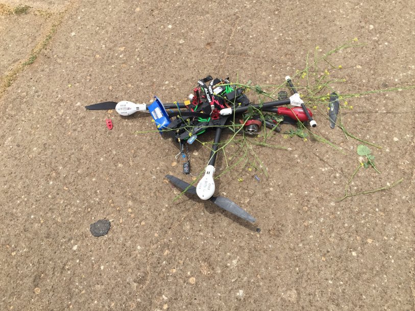

So yesterday I sadly lost my beloved Align M480 with SuperX on a violent crash. My question is should I use the SuperX on the new build? Should I just discard it? How can I test its integrity/functionality? I will be building a Skyhero 700. I suspect the cause of the crash was GPS antenna came off of the stand while on GPS hold. Propeller cut antenna in flight. Every part was recovered from crash site except the GPS antenna.

Yes the FC was secured to the frame. But I wasn't able to find the GPS antenna no where near the crash site. I suspect that maybe the antenna came off and one of the props cutoff the cable. Could that caused to loose control like that?

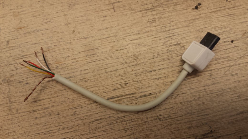

Pretty good chance the GPS wires may have shorted when you lost the puck. Did it cut through the cable or yank the plug out of the IO?

Just like the picture above, it cut right thru the cables. I never recovered the antenna itself, plug was still attached to the FC.
