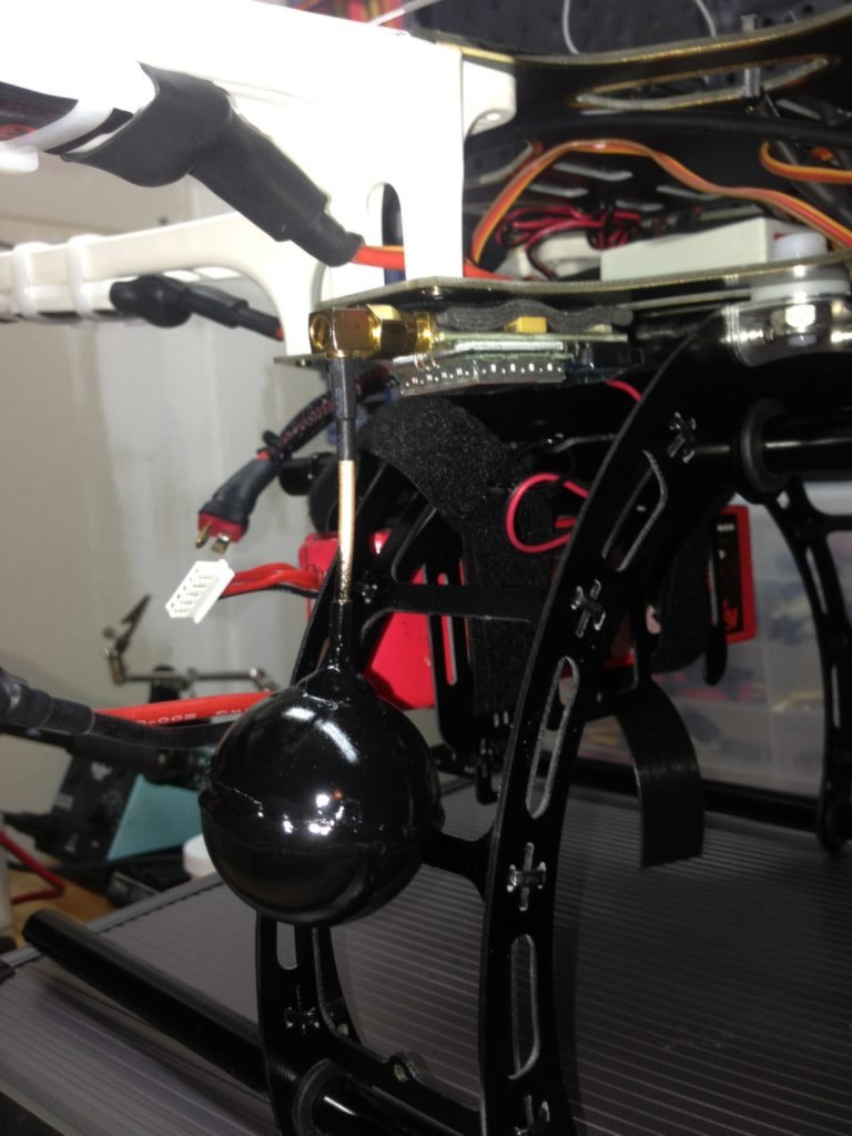

Ok here she is. I put the ping pong ball over the bluebeam just yesterday to protect it so I don't think that's the problem. I read as long as its facing down or up, the antenna should be fine. Anyhow if you see anything wrong point it out :)
View attachment 9598View attachment 9599

plingboot
Have you tried using the stock rubber duck antennas, just as a test to see what range you get with them and see if it might be a Tx antenna issue.
Other options are IRC SpiroNet antennas and the new airwave 5.8gHz Dominator module - not hugely expensive - which IRC suggest doubles receiver range.
See how you got that antenna shrouded in landing gear? Change that up, if possible remount it so its pointing up and clear and free of obstructions. I also see gobs of wire. On mine to make them work as good as possible I trim down every wire. Eliminate all the plugs, RCA, etc

Good idea Plingboot, I will try the original antennas to see if its a faulty antenna.
I'm not sure the spironet will do better than my bluebeam? The crosshairs looks nice and from the reviews is very good. But just how directional is it? Will I have to put a tracker on it or follow it with my head? Hehehe
I will raise the antenna up top as you said Kloner. And I guess I should spend more time organizing the platform and less time spending money Hahahaha

It has a 120 degree beam good for miles out front and decent reception all around it. The spiro net patch is less gain but even more omni. It is the only kind of receiver antennas kloner flies on all frequencies.
Do this just to prove to yourself, take the vtx, cam and power it up out of the heli. Check reception like that.
