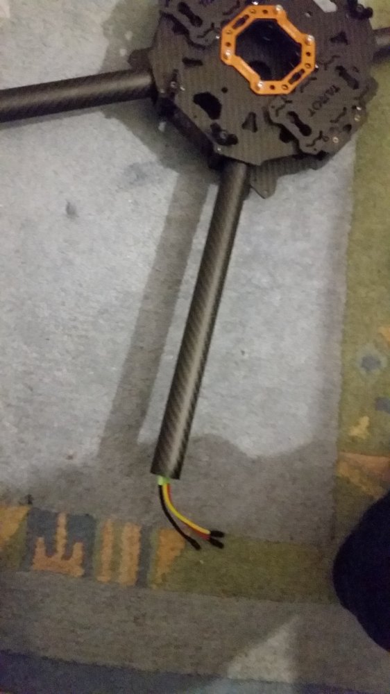

you are right I need to consider a spare motor esc and props, I can always order one of them... have solder connectors wire and shrink tube. Balancer for props is on the way but I have no idea about balancing motors?
Windy
There are several videos showing how to balance motors. You will have to get a vibration meter or use you cell phone with a vibration app.
Kratos
ok esc in tube, yes or BIG NO, reason is cooling of esc, they said it can get very hot, if i put it on bottom of motor I wont have enough wire :D 30A multistar

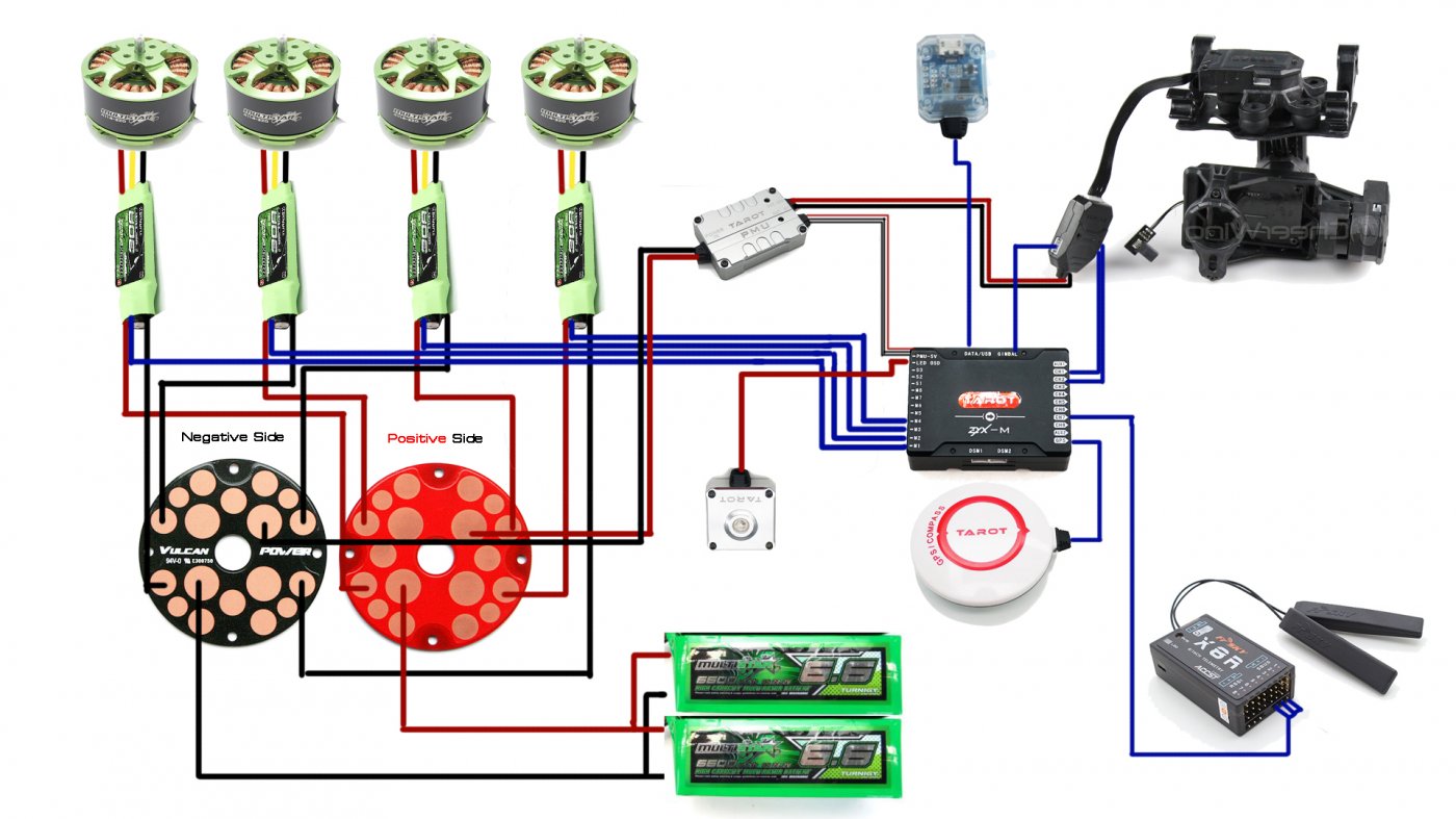

Ok I made small scheme, I dont want to weld things and then find ot that I made mistake,
So,
Motors- multistar 4114 320kv
ESC- multistar 30 A
PB- Vulcan 250 A
Bateries- MUltistar 6600 mah x2
FC- Tarot zyx
receiver - frsky x8r
gimbal- Tarot t4-3d
PMU- tarot
GPS-tarot
MANUALS:
So the question is gimball and flight conntrol conected good? does gimball go directly to power board or tarot PMU out 12V
receiver does it need power and other connections. Does whole configuration need other things like switch for on and off drone, some sensors for batteries etc. I made parallel batteries, reason I need time not punch.
