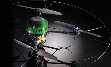

I agree that there are an awful lot of irresponsible operators. Taking someone's eye out with a spinning blade is not in any way compensated for by insurance. There are two simple protections for this and yet I rarely see one and have never seen the other.
Firstly, a simple lightweight cage surrounding the props - CF rods with kite connectors, or a more "manufactured" solution with lightweight mesh screens supported from the arms.
Secondly (more as an ancillary to the first), something I've never seen but I'm sure it would "work": folding blades (like those of an RC single-rotor helicopter).

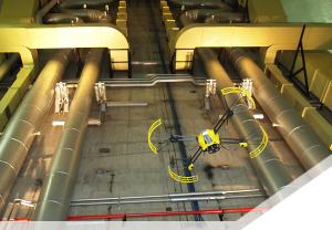

Funny - you chose two examples that utilise what I believe to be the most heavily compromised solutions. The CyberQuad is probably a handful in windy conditions and it's payload capability is highly limited (in weight and position). The FlightVision must also suffer in wind. In both cases I'd have my doubts that there is any net gain in efficiency from the "ducting", considering the extra weight and drag.
I'd say these two are better choices:
View attachment 413View attachment 412
