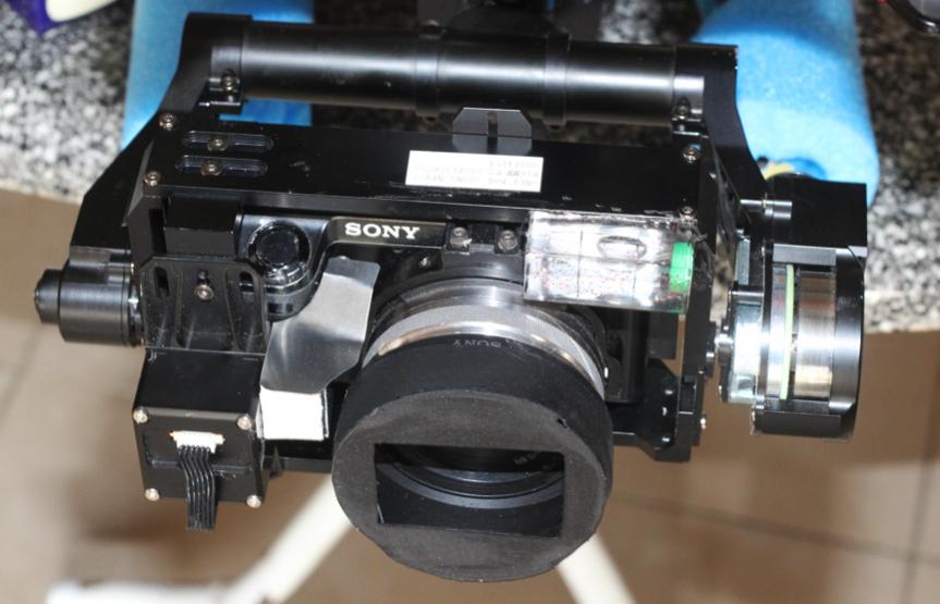

DennyR
Have you had the same issue?
I did have an issue but with a heli. which is far more prone to this problem when shooting into the light. You must keep the blade shadow off the front element and not just shield the angle of view. Inside the hood, it must be matt black or it will bounce the light. We use Barn Doors for most situations on the ground but always a shade is used.
