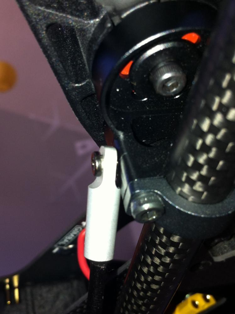

Would love to get a more definitive answer on this as I have the same issue. I have it mounted exactly as show in the manual... and from what I can tell, if the rod was a cm or so shorter, it would seat correctly. Can someone who has an S800 that the rod fits please measure it? That would explain the problem if the first batch was just too long...

I got responses from DJI via email.... though the reply was surprising. Here's the email thread:
Hi Terry,
I finally have my Pre-Order S800 out of it's case and the support arms
do not seat correctly. I've attached a photo so you can see what I
mean. I have heard from others that they have the same issue... it
seems the support arm might be too long? I've made sure I am attaching
it correctly according to the directions. Help appreciated.
-loren
[FONT=comic sans ms,sans-serif]Hi, Loren,
Yes, you are right. Will show to production and see if any improvement can be made.
[/FONT]
Best regards,
Terry
Thanks Terry... In the mean time what am I to do? Are there new support arms because not everyone has this problem? If there are can I get a set please? thanks for the response!
-Loren
Hi, The support arms all the same for everyone. What I suggest is do not have the screw too tight.
Soo.... There's that.
skivvie
Seriously? Just put a washer on or don't crank it down. It's really not a huge deal, I just wanted to know if mine was screwed up, but apparently this is the same on everyone's setup. It's not a deal killer, and his response seemed reasonable enough, he stated the facts and what not to do. It's not like the bird won't fly.

I had the same problem...but no big deal. Instead of writing for support - which you will never get anyway - I took my dremel, took some material off and bent the mounting stud carefully a little bit to the outside...end of story. I am too long in rc-models and have to fix that kind of thing over and over again...you get used to it. Apart from that, the whole construction is a far cry away from being rigid anyway...But you are right, you payed some serious money and could expect a product which is well designed (what to some extend it actually is)...und not sloppy answeres from "customer service".....
