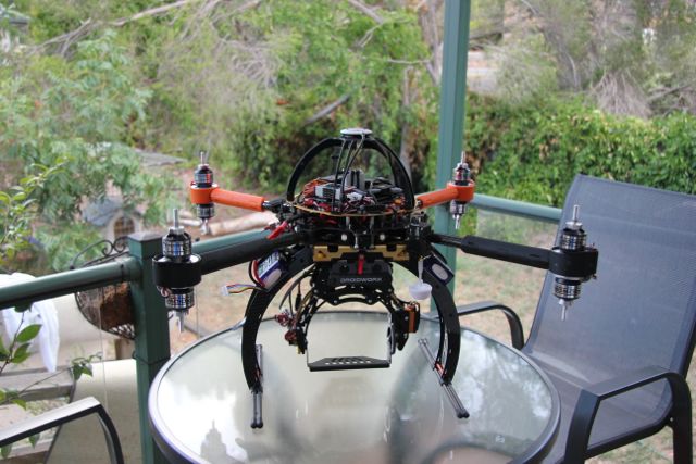

Hi Guys i just wanted to share. My s800 after tinkering like crazy in the workshop is now sitting rock solid in the air. I took all the stickers off the motors and checked if they were vibrating with a app on the iphone and managed to get rid of 99% of the vibration. all of them were off balance with those silly stickers on. there was one motor i balanced with a tiny piece of duct tape. props were re balanced. I moved my imu to the centre of the top plate and stuck that down with .3 cm thick 3m VHB. myh gps i moved to the centre of where the imu is supposed to be.
No funny shaking.
I am running 2 x 5500mah genz ace batteries. i have a home made gimbal and my sony NEX5 with video transmitter.
i got a 24 min flight with no blinking white lights no shaking and no wierd behavior. Gps lock solid and no problems. I will check again tomorrow but so far after three flights it seems very happy in the air

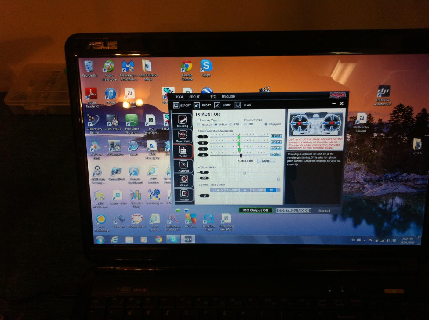

my gains are 180 180 185 180 100 100
imu -3 0 0
gps -6 0 -16

i took one arm at a time, took the prop off and used the app on the iphone. I put the phone against the base plate resting on the arm and spun the motor up to see how much vibration there is. i then peeled the sticker off and cleaned up the glue residue from the sticker. 90 % of the vibration was gone. i can get it better but for now its good

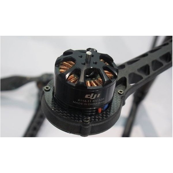

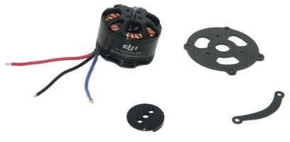

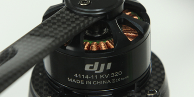

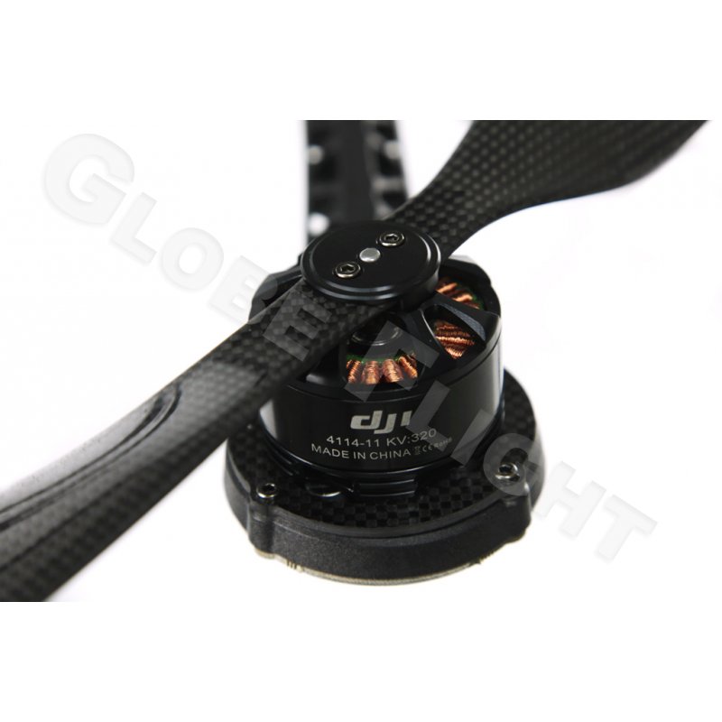

That makes sense, I am just wondering about the stickers.....I only could find images on the net with motors without stickers:
View attachment 9342View attachment 9343View attachment 9344View attachment 9345

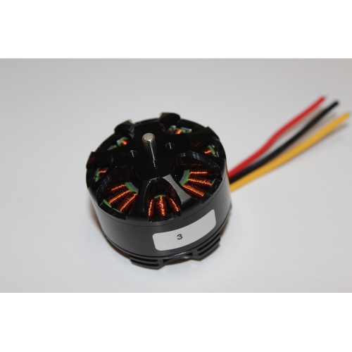

The only S800 motor I could find with a sticker was this one, but it doesn't look like an original motor :
http://www.fpvmodel.com/4114-motor-320kv-s800_p265.html
I just know the motors for the Flamwheel series got stickers.....very strange.
Chris
