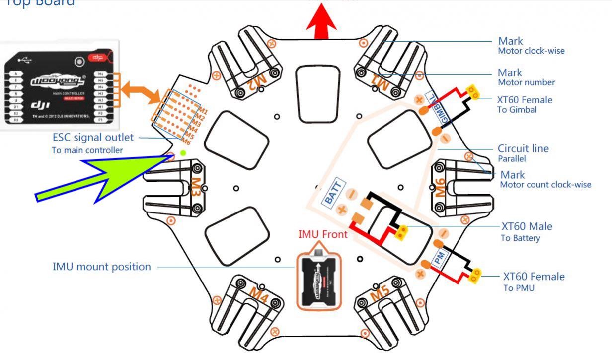

Then I realized that the screw does not fit to any of the wholes of S800 top board. One moment I totally forgot that the top board is somehow a circuit board (distributing power to ESCs). I drilled a little whole on the plate (on the green spot image below).
Screwed the thing in place. Powered and boom! A spark went off the GPS mounting place. I realized what mistake I had done. Dismounted the GPS. Powered S800 again and everything is still working. Ran the motor check one by one via wkm software. Motors run. Since the motor check only runs motors in low speed I don’t dare to fly it now. I don’t know if the defect circuit will still handle to feed full power to related ESC while 7kg s800 is off the ground.

Nigelbrogan. Look at the picture I did attached to my previous post and see if you have drilled the danger zone. Hopefully not.

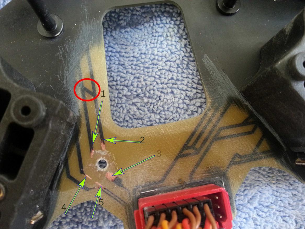

Thanks to everyone giving advice on this. As mentioned I scatched the upper side of the top plate and the circuit was not there. Then I disassembled the bottom plate. The picture bellow shows the hole from the back side of the top plate.

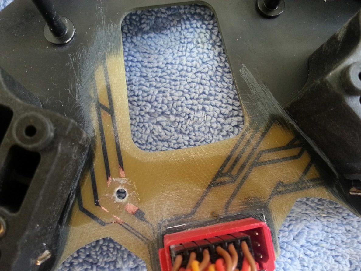

I started to scratch around the hole with a hobby knife which was a bad idea. Even though I was very cautious I ripped off some of connections. Then I continued with a soft sand paper and scratched the coat around the hole and the circuit appeared as bellow.
Lane 4 and 5 were connected and I scratched them off by mistake.
Lane 1 and 2 are connected together where the red circle is. The voltmeter indicates that they are still connected.
I have a strong guess that both lane 1 and lane 2 have been connected to lane 3 before drilling the hole. But I am not 100% sure. That is why I have not soldered them yet. As Chris said the lanes are very thin. Any ideas on solder what to what are welcome.

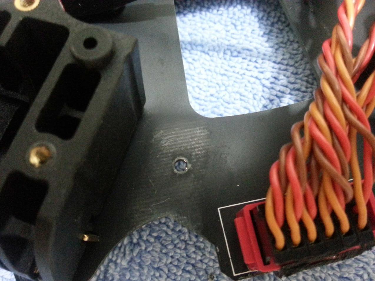

Lucky you, I still have one old top-plate in my workshop....so I just sanded it down arround the area where you drilled a hole:
I hope this helps....
Chris
saidquad
God bless you Chris! Thank you very much. That old top-plate on your workshop along with your effort and goodwill made me very happy. So I am going to solder lane 1 and 2 and 3 (referring to the second picture on my previous post) together and test the system. Would it be ok to solder them using 24 AWG wire? I can lead wires around the hole so that I can still use this hole for that jolly little hinged GPS mast mount! (as MombasaFlash calls it). I can’t use the central standoff to mount it because I lay the lipo packs over the top plate.
