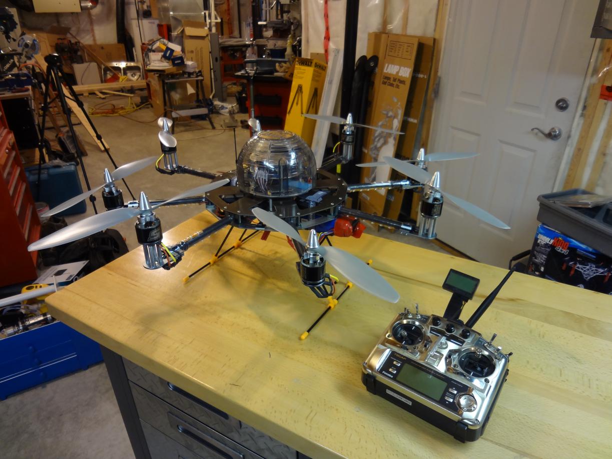

Ah, OK, I understand now. I agree, most multi-rotor frames are way too small. Here's what I have designed. The frame is almost 12" in diameter. Lots of room for mounting ESC's, etc. Very stiff as well, it helps the arms are so short. The only disadvantage I can see so far is that it is quite a bit more expensive because it uses so much Carbon Fiber plate. However, you save a lot on the tube arms too.

Good design Bro, 5cm less diameter would be perfect. how good is it in high wind? What reason you raised several motor mounting?
R_Lefebvre
Arducopter Developer
Some motors are raised because the props are overlapping. It's got 12" props on a 630mm frame. It flies excellently.
