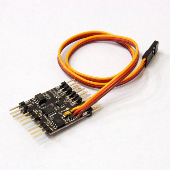

Next was a little harder, there is a RC switch board, called the RCCC 3in1 board, there are only two place in the United State selling them one is Ready MadeRC, and the other getFPV.
$29
The board is pretty robust, it has the ability to do many things, other then shutter control you can also set it up to switch between two video sources, and also control strobes. The hardest part is figuring it out, however at the end of the day it works like advertised.
There is a decent setup manual but one of the things they are not good at is identified from scratch how to set up the board.
If you do look into this board and get it just remember the following
- the rc connection that comes with the board powers it and also it considered ch 1.
- where you put the jumper to program the board, top row of pins are ch 2, and bottom row of pins ch 3.
- In order to trigger the shutter that process take place on ch 3
- when you hook up the camera wires to the board place blue on common, green focus, and red on shutter.
