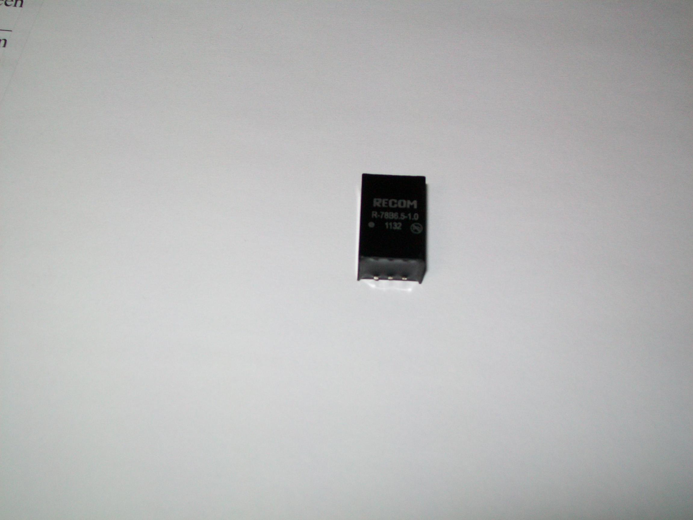

I have a av 200 pro mount on a AD6 HL. the camera mount stopped working in flight. When I removed the canopy to hook up line to MK tools a small recom box fell out. I think it controls the mount. I ordered another one. Would I just solder the new one in or is there something else that need to be done? Can't understand why it would some loose!

Hi,
first of all, this 1A Recom is not powerful enough to drive 2 or 3 servos of the AV200,
you should order a powerful SBEC 6V / 5A and power the servos of the av200 from the SBEC.
Then replace the Recom, solder it back and additionally glue it to the board. Recoms have very thin pins and due to vibrations over time they can break.
