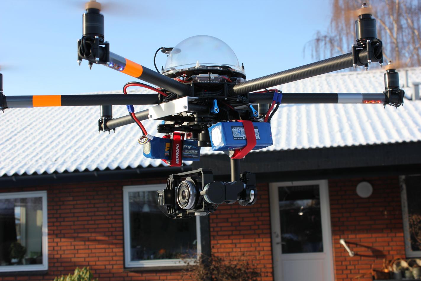

that is great. you got any pics of your setup. i would be interested in your ground station. i have recently ordered the same setup. thinking i might mount a small monitor on the radio, not sure. i am a 1 person setup though, sounds like you are 2 person.

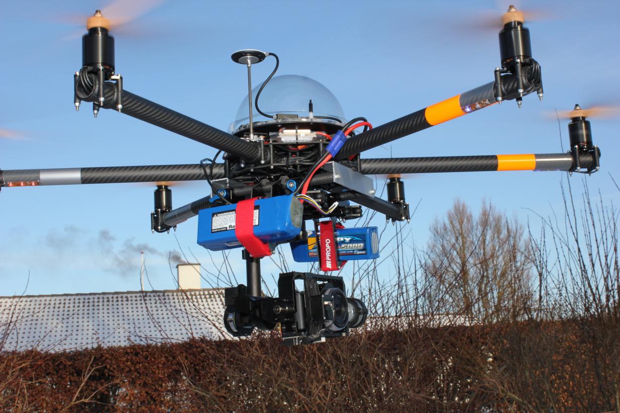

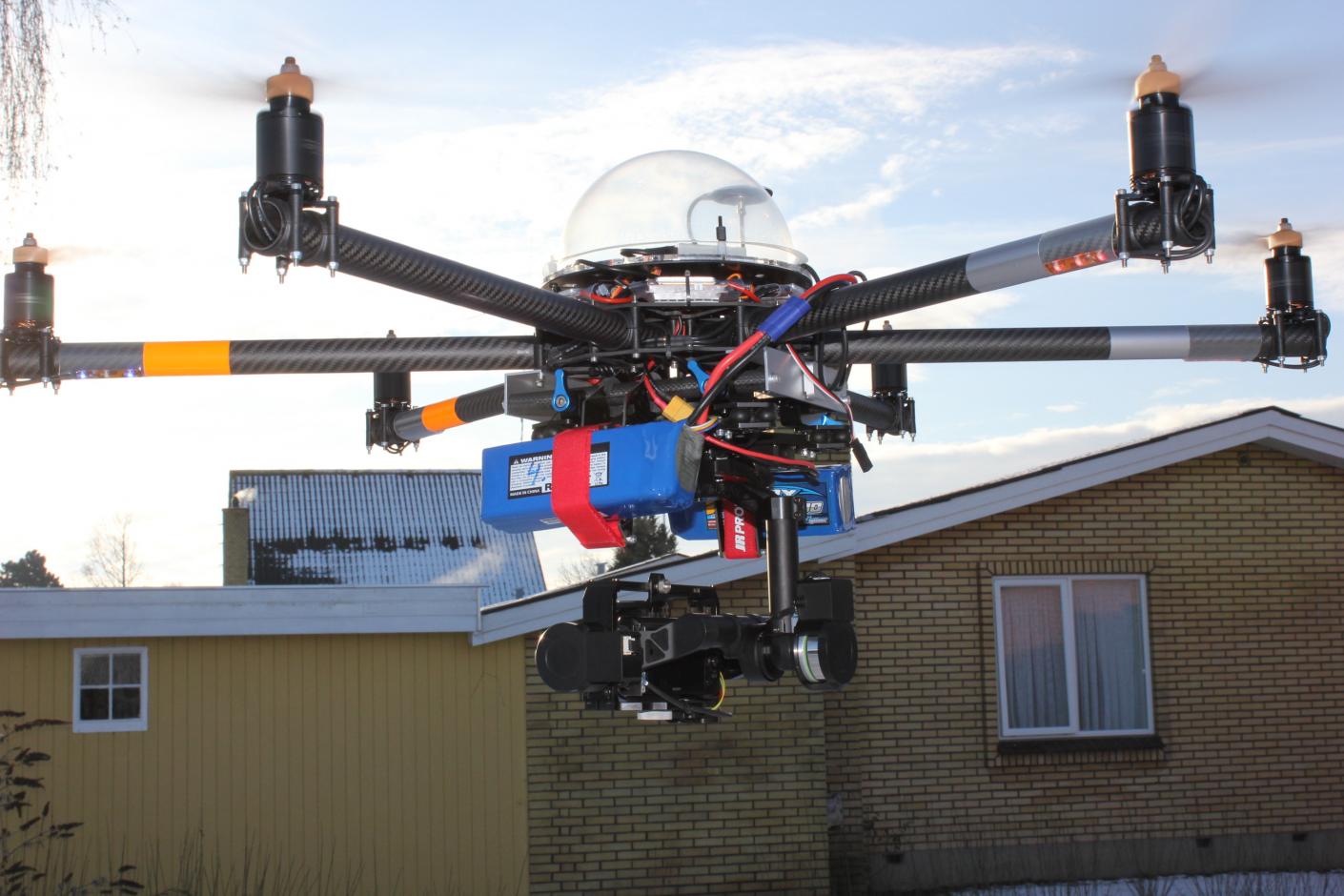

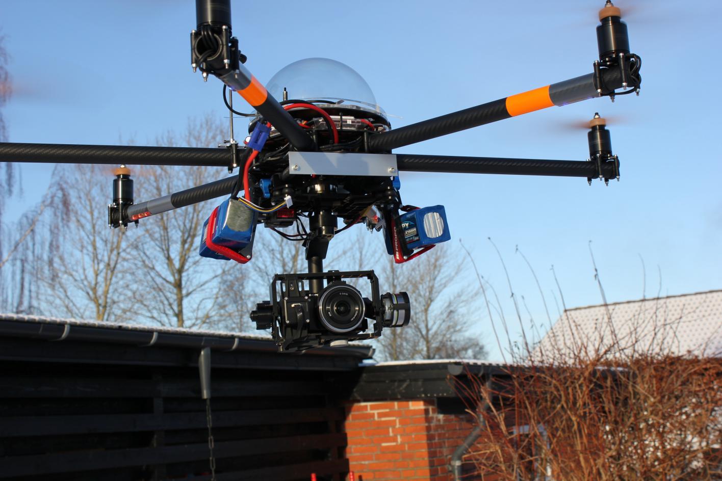

Here is a quick video from the first flight. I did not bother trying to set the camera up well. It was just in manual 1080 60P.
And some quick photos from my iPad:
View attachment 9223View attachment 9224View attachment 9225View attachment 9226View attachment 9227View attachment 9228

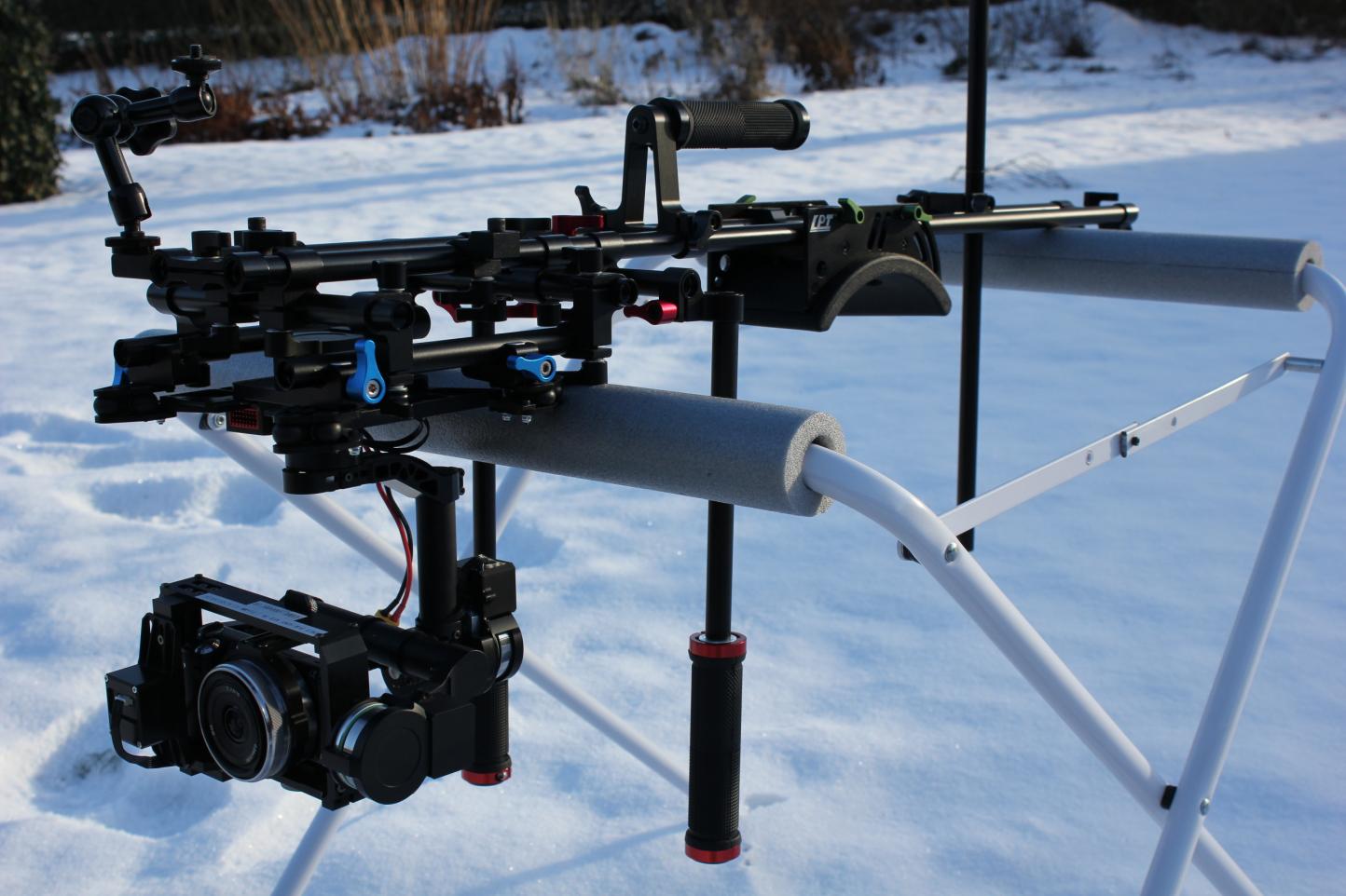

The monitor is a very good 9" Pro NTSC HD-SDI monitor from Ican (overkill, but I have it and several Marshalls as well, I have a video production company) it is on a light stand and is powered by an IDX battery (12-16.8v This is a pro video battery like AB) I have an inline regulator to keep steady 12.1v to the receiver.
I plan to make a harness for myself for single person setup. As well as a small bracket on the light stand to hold the Zenmuse RX for single person shooting. This actually works quite well in slow planned shot.
My website for aerial video is:
http://iflycamera.com

good stuff olaf. i have seen your other vids from 450/550. they are super impressive, cant wait to see what your results with the mighty z15.
Thanks for sharing...... tremendous work with excellent equipment. BTW - I just discovered today when testing DJI Ground Control Station with datalink 900Mhz that it uses Can-bus only which entirely frees up the alternate s.bus......which seems to suggest..... no s.bus conflict between WKM and Zenmuse!!!! sorry for the late news on that. Comes complete with photogrammetry functionality as well as search and rescue grid waypoints, etc., etc.
In any case the Futaba T8FG's are exceptionally great choice as well.
THat's a big animal you've got there olof. I plan to get all that stuff as soon as the divorce settlement comes thru'.:highly_amused:
Andy
P.S Lovely 'steady footage' just shows what's possible from 'stock' stuff that wasn't around 10 years ago?
