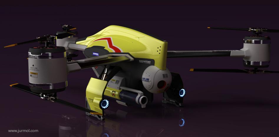

I really don't think FF could have a "copyright" on that gimbal design. I don't see any new or unique ideas there. I would bet if I bought my 7 year old son some Lego Technic and told him to build a gimbal, he would produce something looking pretty much like that. ;)
I want to see something that is DESIGNED!

Indeed...is it real? collective pitch Y6??

No, just a rendering. But isn't it gorgeous?

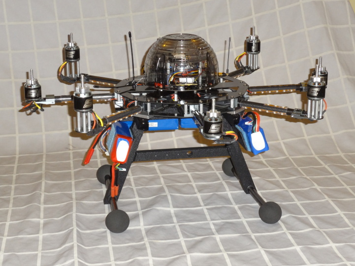

No, not at all. If you've seen the things I've done, you know I'm all about function over form. What I really complain about is that so many of these designs lack function, forget about form. The only reason people think they look good is because of the pretty carbon fiber chequer pattern. They might as well be ABS tubes with carbon fiber vinyl wrap. I like the look of the Photohigher Hero/Halo? gimbals. They aren't "stylized" but they seem to be nicely made. Using CF sensibly.
Here's the Octo I designed/built.
The construction isn't that much better or different than everything else on the market that I'm complaining about. But it's what I could manage. In my basement. That's the thing. All these basement-grade designs being sold for high dollars.
At least this one has a few good ideas you don't commonly see.
- Dedicated space for ESC's in the main frame instead of just asking the user to zip tie them wherever they find a space.
- Multi-level, logically layed-out, avionics section seperate from the power section. With a dome for protection.
- Landing gear, batteries and gimbal (not shown) mounted on a rigid, vibration damped subframe.
- Center frame large enough to contain all components with no wires or ESC's ziptied outside it.
- Arms short to only provide prop-to-frame clearance. Short arms are stiffer, and allow smaller diameter tubes to be used.
- Overlapping props keep the overall size of the thing very compact with no loss in lift like a Coaxial. This thing was only 670mm, but could lift 5 kg, IIRC.
- Since it's small, no need for complicated, weak, and failure-prone disassembly or folding mechanisms.

nice work R.
the only thing is that ESC's have a comment in the directions about the rating being dependent on a 5mph airflow over the unit. didn't you add heat sinks? that heat goes up into the electronics then, no?

They would still have airflow there, due to induced airflow through the frame, and I left huge cut-outs in the frame. Plus the ESC's were over-specced. Plus I cut out a window in the wrap to help. I had no problem at all. The design worked well. But I'm just going to try an H-8 because I learned how hard it is to keep the props out of the frame with these layouts.
My design will actually be sort of similar to your XY-8. Except it won't require any landing gear at all since all the props are on the top.

Jesus Christ....that thing would make my day. Best looking rig I've ever seen....dunno about funcionality.
http://www.tuvie.com/hatchet-concept-uav-by-jurmol-yao/
http://www.yankodesign.com/2012/12/10/the-hexicopter/
http://www.truonex.com/projects/7452
