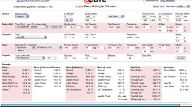

Putting together a Y6. I've built a few multi's but this is my first coaxial setup. After countless looking and researching for the correct motors I have made a choice and wanted to see if anyone had any input. I tried to research everything, but figured someone with real world experience may know. Got the proper frame, flight control, ESC's. Ready for Motor/Props and batteries. Ideally I will use Two 4s 5000mAh LiPo's ran in parallel, and would like to achieve at least 15min flight time hauling my camera & gimbal.
My Y6 is ~ 2.8kg AUW. I have selected the RC Tiger Motor MT2814-770kv to run with 11" CF Props. If my math is correct I have roughly 3.7kg of thrust at 50% throttle on these motors, which would be more than enough correct? NOW, I might be incorrect, but I assume that is what the math came out to when looking on the Tmotor website.
EDIT: I found the Tiger Motor MT2814-19 400kv to be much more efficient, cooler, and better motor. I can get it for the same price as the MT2814-770kv. Does anyone know if the 400kv will run on parallel 4s batteries?
eCalc shows my results but I am not clear as to if this is for just one battery or two. If I calculate the motor's thrust at 50% throttle I "believe" I am well in capacity for this setup if I run parallel. I have attached my ecalc sheet because many of you probably can read it better than I can. Thanks for any help

I can't read the thumbnail on my laptop... it's too small!
I have a very similar machine to you, I run 12x6 APC clone props with 5000/10000mA 4S packs and I'm at 50% throttle with two packs.

Hmm for some reason every time I upload the image is tiny. Even at 2000x2000 let me see if I can upload on another computer. In the meantime, what motors are you running on your rig? Thanks for chiming in!

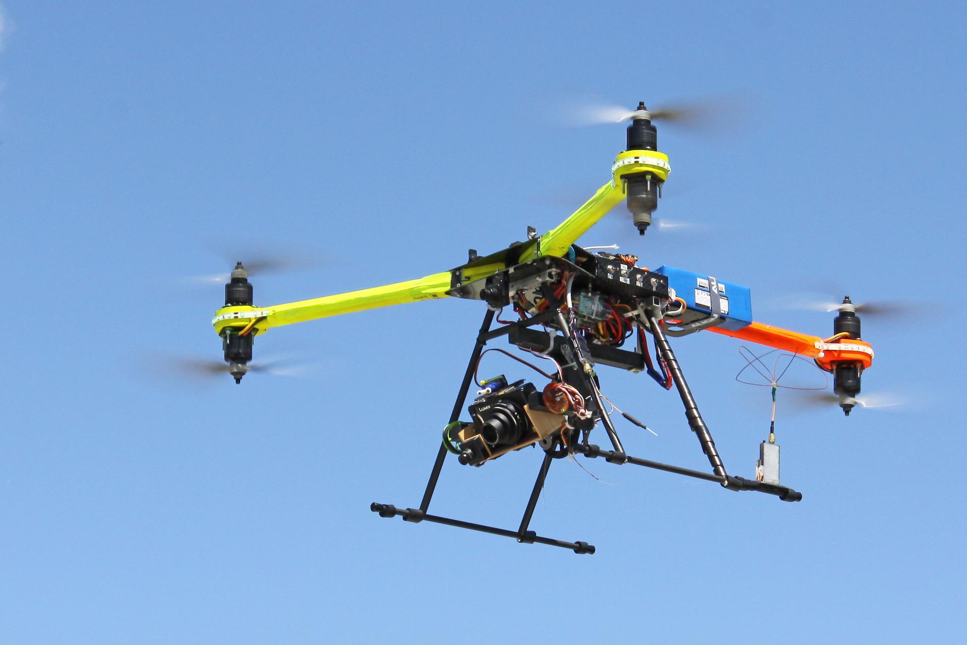

Sunnysky 2814/11 700Kv with 12x6 APC narrow-blade clones
The build blog of the original design is here... http://www.multirotorforums.com/sho...s-diy-Y6-quot-build-thread!-800mm-motor-motor
It's been rebuilt since then with 1.5mm carbon sheet and carbon u/c.

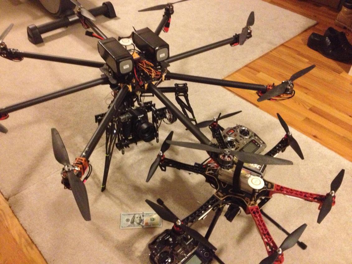

Pete, is that gimbal with the LX3 your own design? I have a new LX100 and searching for a gimbal to mount under my hex, building my own at this point but always searching for an alternative. May try a Y6 build this winter as well

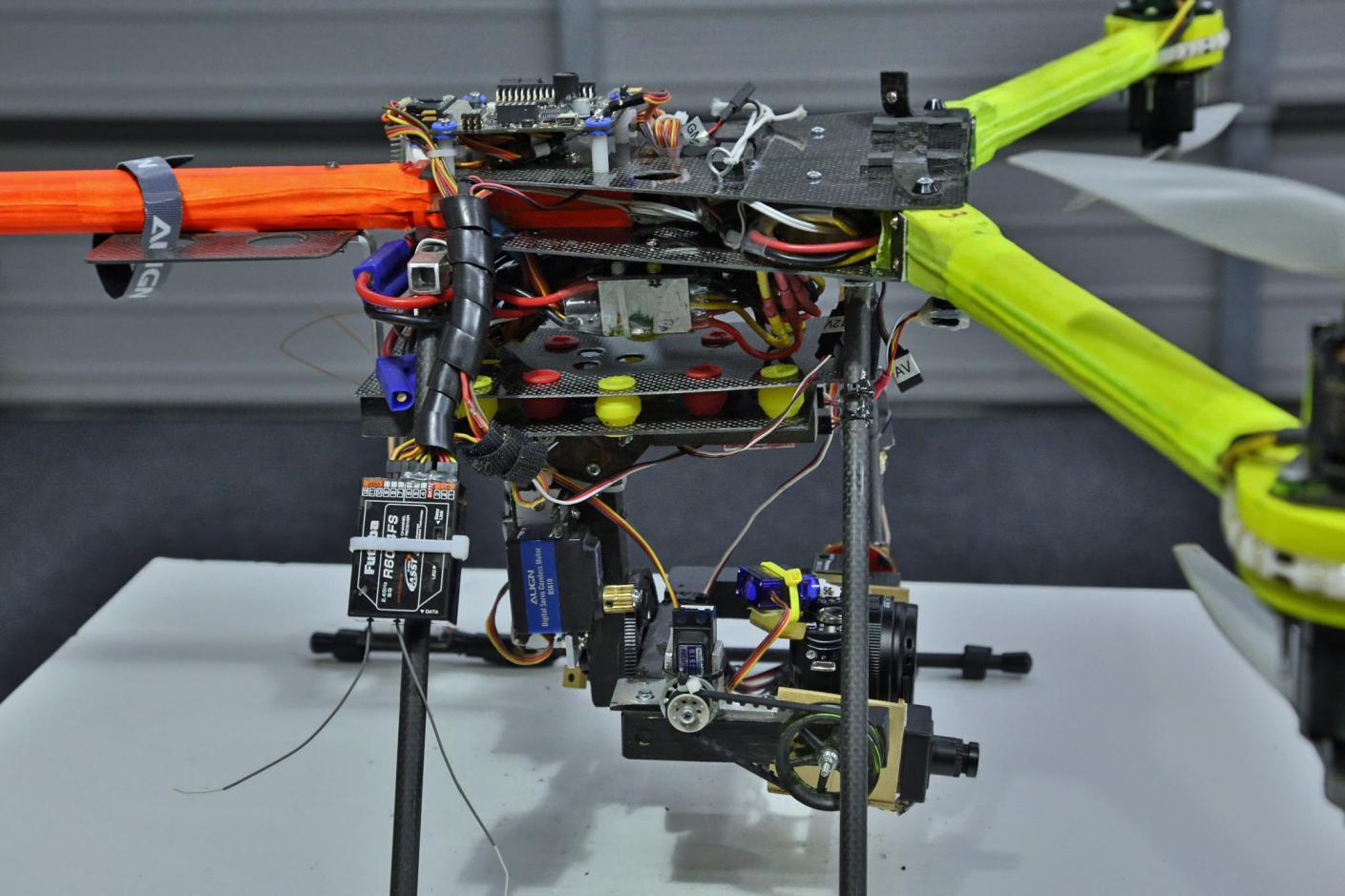

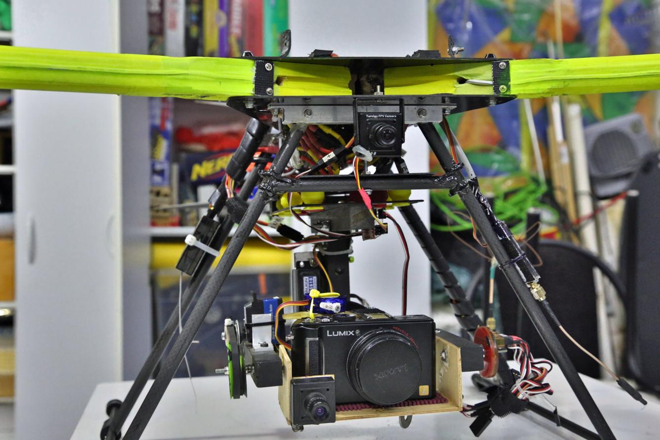

Yup... my plywood diy gimbal with 360-deg mod'd servos and one of the few almost-ok Photohigher RSGS Skyline controllers in the world ;) Great for photos but not smooth enough for video.
I'm working on a brushless gimbal for my Panasonic handycam. I've been looking at the LX100 but the lens flare is putting me off at the moment. I used to have a Sony RX100 i which rocked... until I smeared it on the road lol.
View attachment 21527View attachment 21528
