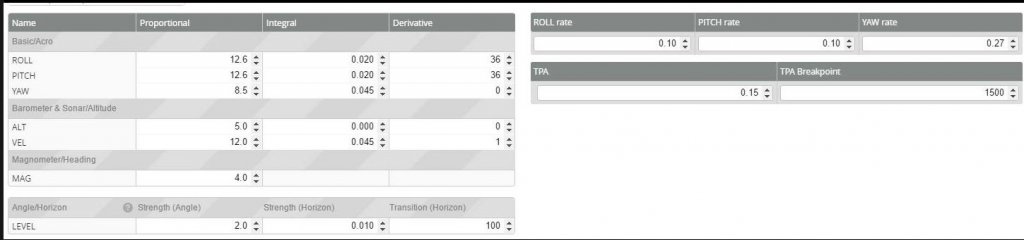

what do you suggest the D tuning should be i'm attaching our current numbers , in summary :
P is okay, I - not tuned yet, D (if low shakes in turns, if we increase it, it starts going up on its own and still shakes in turns)
