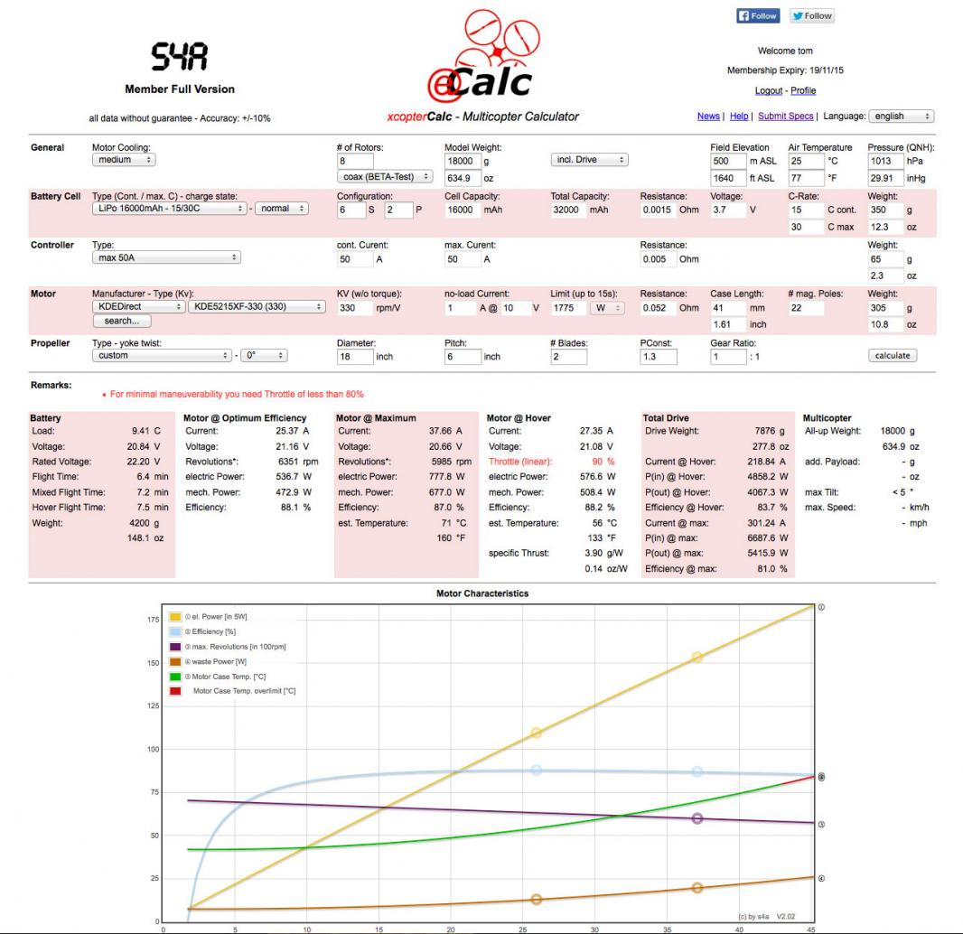

KDE 5215 Motors, KDE 55AMp ESCs with 18" Props - I am a little in the dark here but this was what Aeronavics spec out their Bind n Fly package with although I can't seem to get it to "fly" in eCalc (see attached). What props are suggested??

If you will be flying at 20kgs with that setup, the motors will be pushing those ESCs. I know the specs say that the 18 inch props and the 55A ESCs should be good but I base this on the advice I got from Patrick at KDE. You need to be safe when flying that amount of dollars so I would go with the 75A. In fact that is exactly what I have done with my 20kg lifting X8.
With the 75amp ESCs I am only getting 3.9 minutes of flight time... Also, motors overheating. It is a tough balance...

Moving from 75A ESCs from 55A ESCs will not affect your flight time. Not sure what Ecalc is telling you. In the real world, at 20KGs with 5215 435s and 75A ESCs am getting just under 10 mins using 16Ah batteries if that helps.
teecee
In the real world, at 20KGs with 5215 400s and 75A ESCs am getting just under 10 mins using 16Ah batteries if that helps.
Is that with an X4 coaxial configuration or a regular 8? What prop brand, size and pitch? KDE motors and ESCs?
Thanks!
Carapau
Its a coax octo using Tiger 18x6.1 KDE 5215 435kvs with 75A ESCs (just realised a typo- I originally said 400kv but they are of course 435kv Doh!)
Carapau
Just put my details into ECalc and it reckons I will hover at 260A at 20kg. I have telemetry on my current and in reality I draw approx 160-180A in the hover. Not sure how accurate ECalc is but in my experience it has always been way off.
