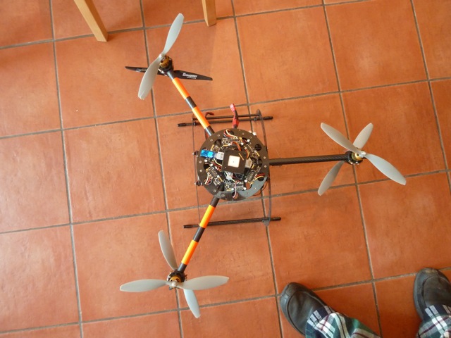

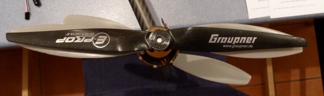

Hello just after confirmation about prop type placement on a Y6 setup. I have an ADX-3 D-worx and have props on but want to confirm if they are correct.
My main concern is the bottom props....do they go on upside down? , can anyone point me to any info. Cheers Jim :)
Hi Jim
See below pictures. Yep upside down. I replaced the 10" APC props with Graupner 10" originally bur now I have put on 11" Graupners and am very happy with them. They are a very stiff prop and the ADX3 descends better in a vertical descent IMO.
