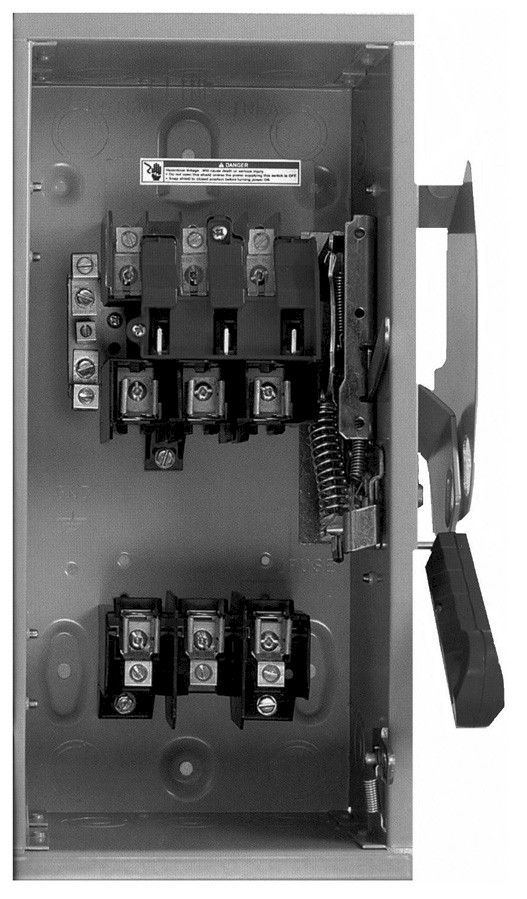

Power switch for 200amps. you need to stop thinking about it since the first that comes to my mind is about 2kg in weight.
Sory but cant be done if you ask me.
Lanzar
Well looks ok but i dont trust another component that could fail in between my batery and board. The thing i had in mind was more
