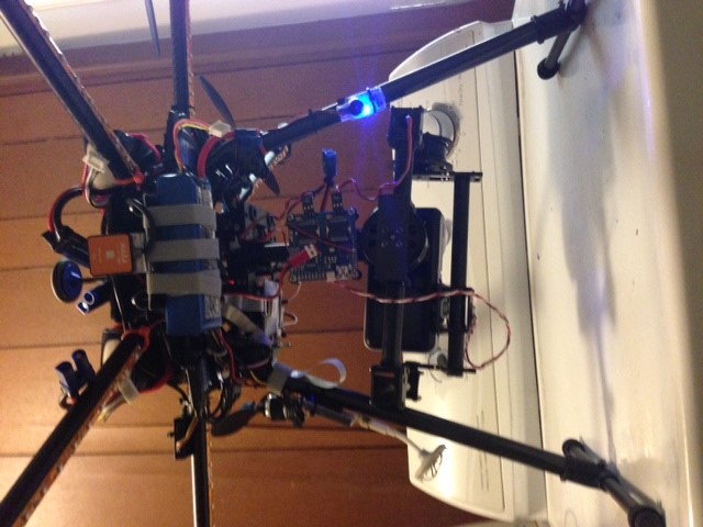

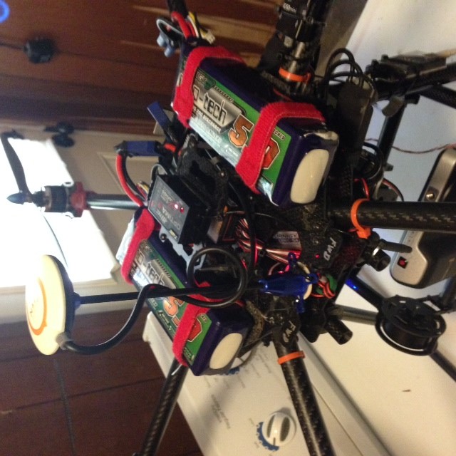

Hi everyone, I hoping someone can please help me with an issue I'm having. I have flown the DJI Phantom for about 2 years and then I upgraded to a custom built Hexacopter recently. I finally seem to have all the kinks worked out but it is giving me other issues now. I shot a video today, while not taking it to high for safety reasons. I cut all the semi-smooth stuff at the beginning and put the bad stuff at the end all together so you could see what it was doing. It was flying smooth and steady on GPS and Atti mode but every so often a very light breeze and sometime not at all and the hexa would act like it was going in to convulsions or like a small seizure. Possible gains not set high enough? Blades not being perfectly balanced? (which they should be) Any ideas?

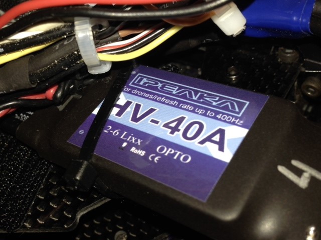

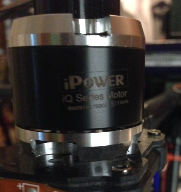

Everything is brand new, iPower iBM2814Q 750KV motors, ipeaka iq 40a opto hv brushless esc with simonk firmware, DJI Naza-m V2, Hitec Optima 9 channel receiver, Hitec Aurora 9 radio

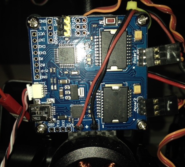

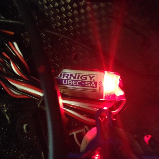

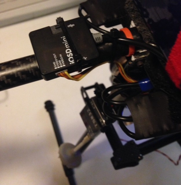

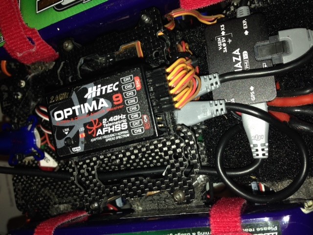

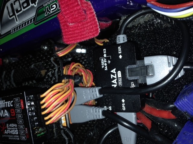

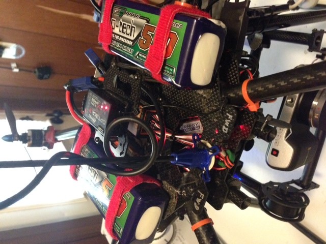

Is there anyone who can help me? In addition to it having like small seizures after a few minutes of flying the ESC and Motors get very, very hot. I can touch and hold on to them without burning myself but they feel very hot still. How hot should motors and the ESC's get? At this link: http://vimeo.com/m/101187323 Password is flight you can see toward the end of the video I put all the sporadic flying that it did throughout the time I flew. Any ideas from anyone? I adjusted my gains for the DJI Naza-M V2 but am not really sure where they should be to start with. Do I need to increase or decrease the gains? It's a generic frame I believe based on the S800. I get perfect flying for around 3 to 5 minutes then it appears after everything heats up I start having the problems. Could it be a voltage problem or any other ideas. Thanks for your help and have a great day!
