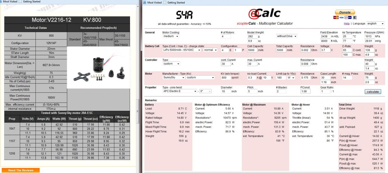

Well I am finalizing the list and have narrowed down the choices. I have much of the odds and ends but still need the props, motor, ESC. Here is my setup with some questions on some things at the end. I would certainly appreciate it if you could take a peek and see if there is anything I am missing thus far. Recommendations are ALWAYS appreciated!!! Attached is my eCalc picture to help.

Why do you like the smaller capacity/lighter one? Is it because you can add more payload? I suppose it is always a "quest" of sorts to find the "Sweet Spot" of where mAh and weight get the "perfect" combination. I just keep plugging in numbers and see how they come out in eCalc to be honest. I am really leaning towards the 800kv motors as I am not planning on doing any acro stuff...just simply flying around with a camera.

I am looking at HQProp's.....I have been trying to figure out the diff between the Slow fly and Thin Electric ones and how they would show up in eCalc.
What I did find was with the 10x5 and the APC Electric E and 10x5 seem to be the best. I was told on another forum that the 3S-4000mAh batts are kind of a sweet spot for our F450 frames. So I used that (still very confused on eCalcs versions on batts when I change C Levels)....and my test was run at 45/60C 3S-4000mAh batts.
With the 10x5's I got a mixed flight time of 8.1 min with 14.3 for hover. The thing that was nice was I found the additional payload was 317g.
Swapping to 10x4.7 I got 8.3min mixed/14.3 hover with only 279g additional payload.
Hope that helps!
