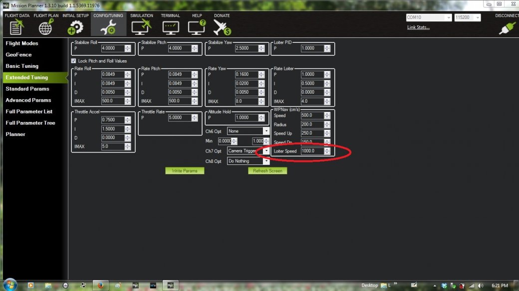

I flew my X8 a few times in Drift with a GoPro and 2D gimbal. When flying in Drift mode I fly it pretty hard (3D airplane roots) and the post flight video clearly showed the bank angles far exceeding the capability of the gimbal. Since rudder is slaved to aileron in Drift it's really easy to over bank, over "G" a gimbal, Bouncing gimbal stops can't be a good thing.
Adjusting Loiter speed is very easy. After adjusting Loiter speed remember that when in Loiter mode the FC will accelerate at 1/2 the set Loiter speed.
