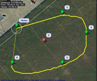

Pixhawk Auto Flight: SuhWheeeet!
Got out to play with Spline Waypoints today. Starting simple.
Flight Plan:
attachment.php
attachment.php
attachment.php
69 Seconds of Air and Grass:
[video]http://vimeo.com/user25835851/review/106550094/929ad03cc5[/video]
Totally autonomous flight. Auto Take Off, etc. The chair wasn't exactly in the middle of the ROI; funny, it wasn't on the satellite imagery so I was guessing...
I liked how smooth the rotation was. Not jerky; no yaw jello.
I left the last 15 seconds on the video so that y'all could enjoy how that AlexMos Gimbal slyly corrected its lost horizon. "What? Me tilt with Yaw?"
I need help getting the altitude smoothed out. An earlier flight was set to 4 meters, and flew at .5 meters. I also had my Nav Speed set to 500 for that flight, so it was hauling *** in a circle just off the ground!
Baro Glitch Protection Distance is set to 200 (100 - 2000 range) (Pixhawk between the plates on a TBS Disco Pro- somewhat protected from prop wash)
AHRS GPS Gain was maxed at 1.000
Suggestions on how to balance GPS vs. Barometer for a steadier height?
I thought that 'Verify Height' was checked, but it's not checked now...
Would a Ublox NEA 8 GPS module be that much more accurate than the NEA 6 that I got from 3DR?
I've ordered a Sonar Sensor with the Pixhawk for my 2nd MR. Has anyone tried mounting the Sonar at 45 degrees down in the direction of travel to estimate the height the MR needs to be at before it gets there? (My goal is to cut nap of the earth circles 1 to 2 meters high at 500ms.)
I am so bloody happy to get this Pixhawk/Disco flying like I knew it could. I'm still scrambling to keep from falling off the learning curve.
Damn! What fun!
Now I have time to clean that smudge off my lens.
