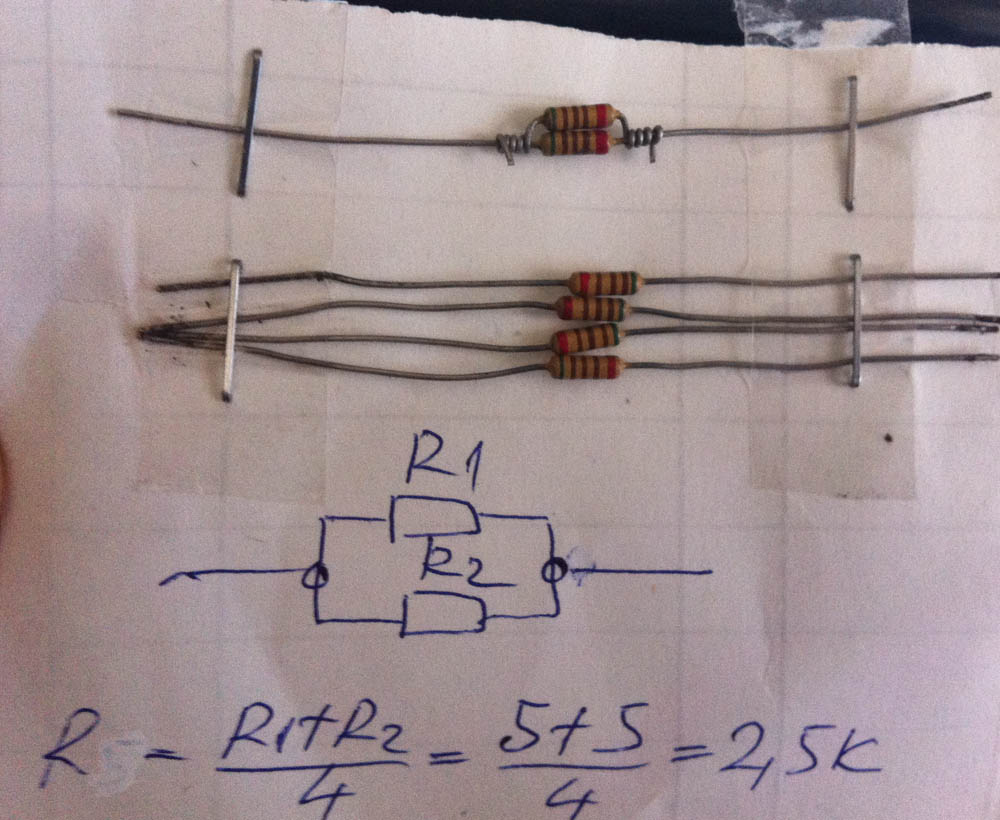

iscorama
Can anyone post a link to worldwide supplier of that 2.5 resistors?
I can't find them anywhere in my small town and can only do bulky solution with some old resistors I allready have:View attachment 6144
