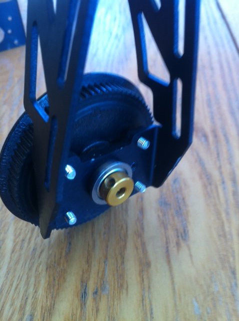

Hi Folks,
I'm new on this forum and am trying to put together the av130 camera gymbal which is straightforward enough but I cannot for the life of me get the bearing off the tilt plate flywheel out of the old one. I'm wary of applying any great force onto it and as you will see from the picture there is no grub screw holding it in place but it wont budge.
Any help greatly recieved as I'm sure it cant be that difficult and I'm desperate to get the gymbal back on the copter.

There is a grub screw on the other side that holds the pulley on the shaft. It's kind of hard to see but it's there, just look around the rim of the inner hub on the platform side of the pulley and you'll see the hole where it lives, take that out and the pulley will slide off easily.

With regards to the pulley - there is a small M3 grub screw holding the pulley on to the shaft. You need to losen it and then push the shaft out. Please be aware that where the grub scrw engaged the shaft it somtimes leaves a small mark which can grab when trying to push it out. so you may need to use a little force. If you support the back of the bearing and use a pin punch and a soft hammer you can lightely tap it out. Once it is out just run a needle file over the high spot.

Once I sussed out that the grub screw required an allen key rather than a screwdriver it was easy enough. The screw was sunk pretty far in making it impossible to see but I'm sorted now.
Thanks for help that folk kindly posted and I need to give myself a pat on the back that I had the patience to suss it out properly. The normal default response of increasing force usually ends up with me breaking whatever it is.
