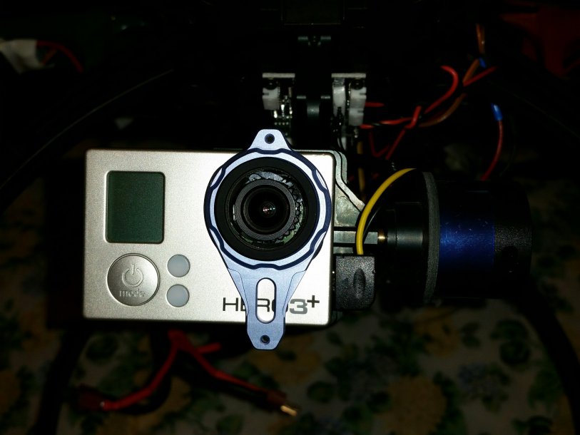

Ordered a 5.4mm 10mp lens from Surveil Zone in January for $99. Did the install myself on my Hero 3+ Silver. It was dicey, but very gently used a pair of channel locks to get the old lens out (surprisingly the locksView attachment 24847 only left a few small marks on the outer ring of the lens). You have to pop out the outer plastic cover around the lens first. Once you break the seal, the original lens easily screws out. The Surveil Zone lens comes with a plastic locking ring. So you screw the new lens in until its in focus (while using bluetooth video transfer to a external screen), then tighten down the internal locking ring. I have been flying the camera now on an F550 in a Tarot T2D gimbal for about four months and the video quality is very good. Just checked, free shipping (takes several weeks, coming out of Hong Kong);
http://www.surveilzone.com/5.4mm-10-megapixel-board-lens-for-gopro-hero-3-m12-1-2.3-inch-cl1184
****Now having posted all the above....The easier route is just purchase a new Phantom 3 Professional. The camera quality is like WOW!!! Most stable aerial filming platform I own.
