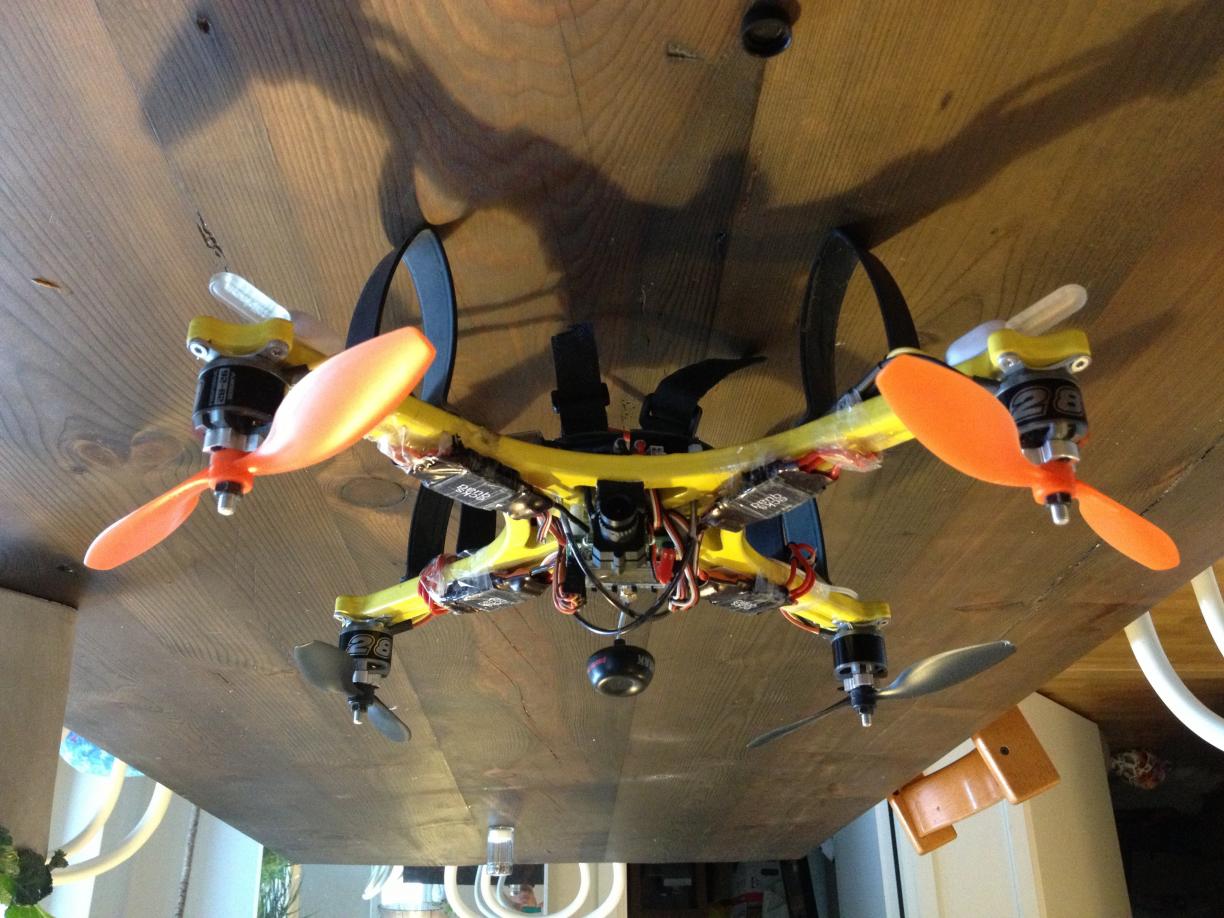

I just completed and have been testing my first build. I noticed that when giving right or left cyclic commands the quad seems to have a pendulum effect and rocks back and forth violently. Currently my p gain is at 45 and my I gain is at 60. I have been back and forth with those numbers and cannot seem to eliminate the problem. The auto level function is off at the moment. Any ideas?
