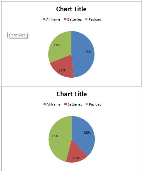

I quick way to gain perspective visually is via an Excel Pie chart. This image shows Kloners Skyjib with two scenarios.....
minimum payload and maximum payload weights. View attachment 17436
What can be most revealing also is the ratio of the camera versus the Gimbal system weight...... BGC systems tend to be a bit heavy relative to the camera weight.

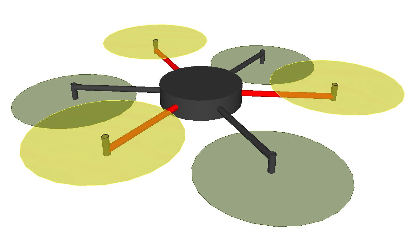

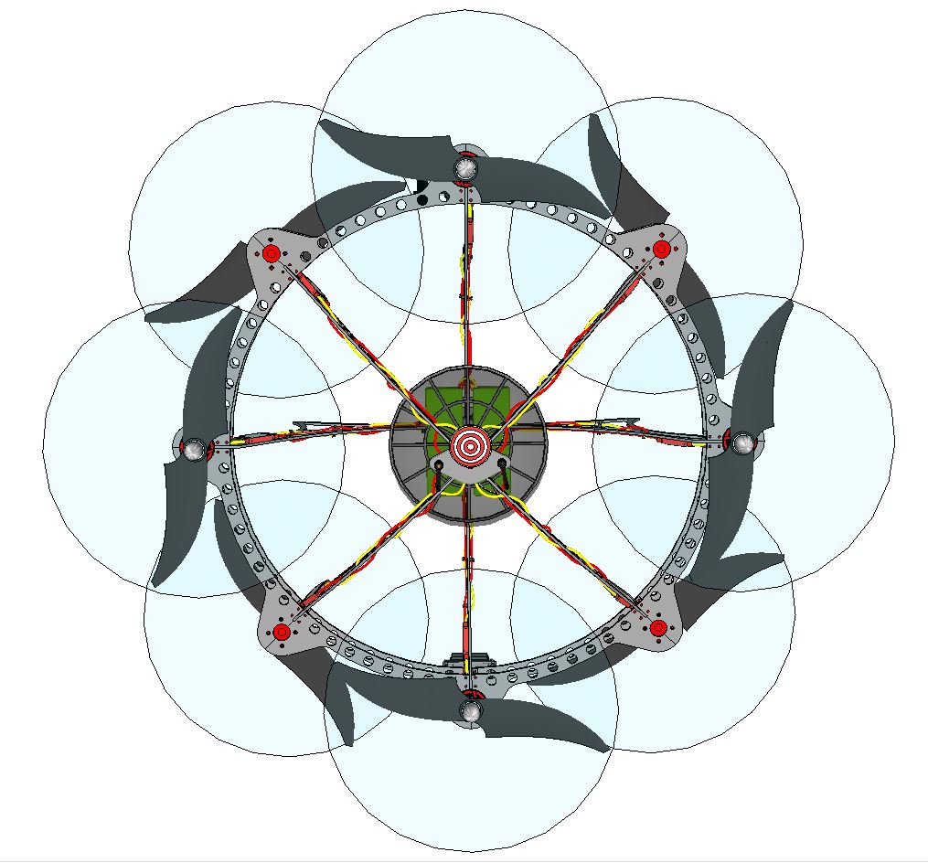

Hmm....has anyone run an offset coaxial X6 with three up at 0-120-240...and three down at 60-180-300? That way you could run bigger prop circles on each side. I saw a link yesterday http://www.multirotorforums.com/showthread.php?18276-Rimcopters where someone had flown this arrangement and said it worked fine. I'll find the link and post it. Here's the link with pictures... http://diydrones.com/forum/topics/octo-x-bicycle-wheel-design-2?commentId=705844:Comment:1453789
View attachment 17470View attachment 17471View attachment 17472View attachment 17473 View attachment 17476
In the first drawing the yellow prop circles are on top and the green circles are on bottom. The first three drawings show 18" prop circles. The last drawing shows 22" prop circles in the blue and gray outside rings. depending on you center section and landing gear layout this might clear or not. Depends on the rest of the chassis. The last drawing is a design I did a few years ago with an offset coaxial X8 layout. The frame dimension here is 692 mm with 15" prop circles.
