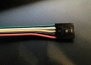

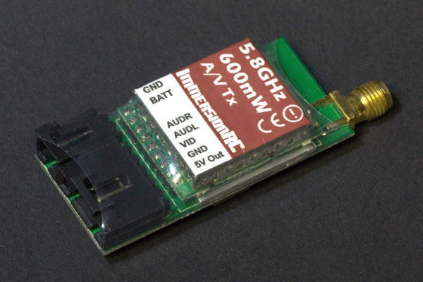

I got my Kopterworx converter but there is a discrepancy in their wiring diagram.
They indicate that white is video and I got the Immersion ready version. Here is the connector it comes with:View attachment 25540
You can see that the third wire is yellow.
Here is the Immersion connector:
do you think they made a mistake and video is really yellow on their setup or should I switch the wires around?

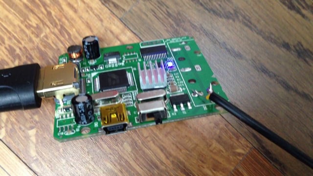

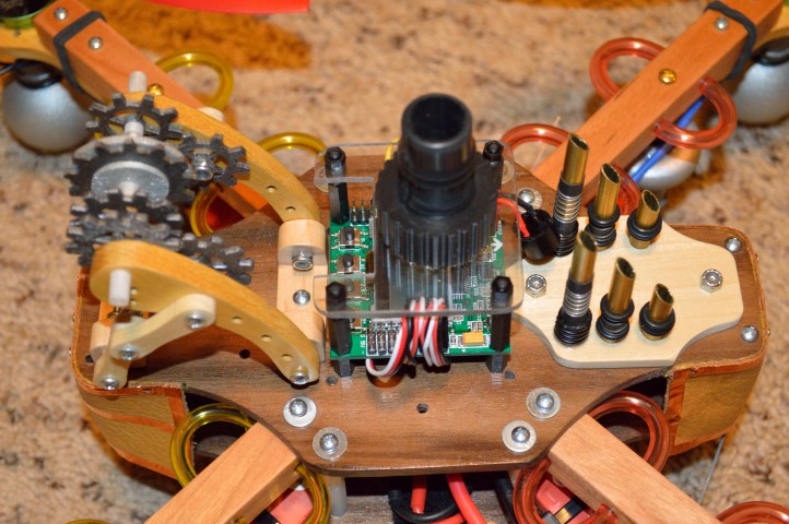

BTW, here is a pic of the board Kopterworx uses. They remove the rca connectors, the usb port and the PAL/NTSC switch. View attachment 25559
Note the 2 capacitors and the heat sink. The HDMI2AV I purchased on ebay looks nothing like this.

Yes, I figured they were just sloppy in their color indicating on their label
Look, everything online shows the video out as white but of course it is the yellow wire.
Already hooked it up and works like a charm, actually mine still has the NTSC/PAL switch

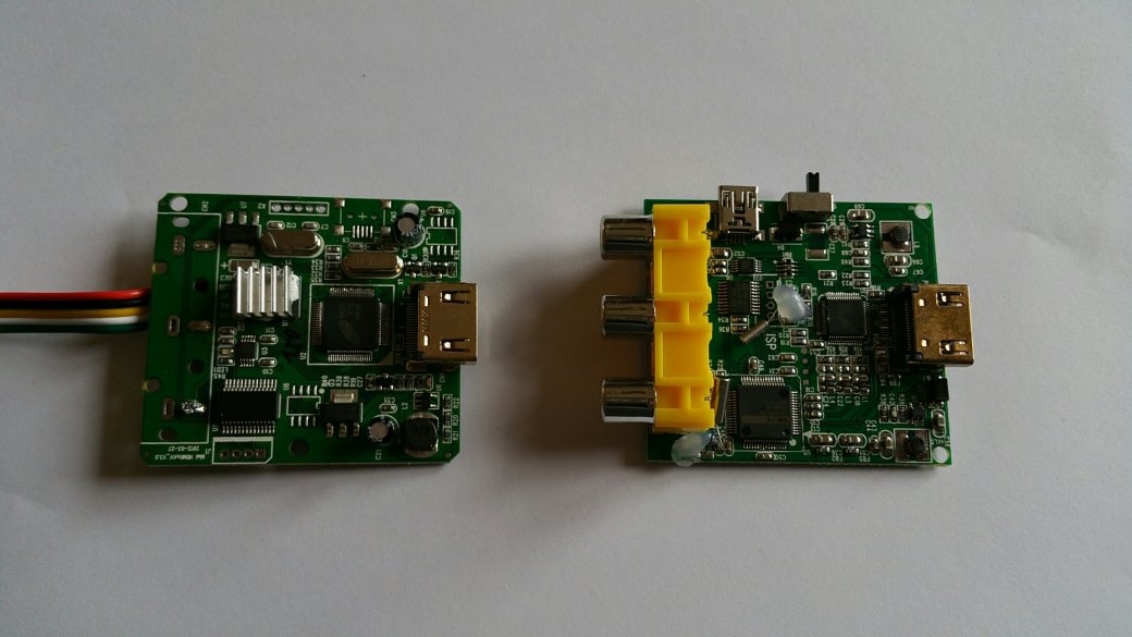

Pumpkinguy
I tested it. works perfect. Here is a pic of the Kopterworx version on the left next to the ebay one I got that doesnt work. They look totally different. BTW, That sticker they put on is directed towards the "Wire yourself version" Not the immersion version so color does not apply here. View attachment 25560

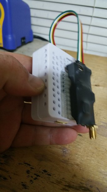

Giovanni59
Good point!. I'm sold, it's going back into one of the boxes and with newly drilled holes.
Thanks for the tip. Even though I think the shrink wrap will ventilate better than a sealed box your method is brilliant.
Pumpkinguy
fyi, I had to trim a couple plastic tabs off inside the box with a razor as the boards are a slightly different shape. be prepared for that.
