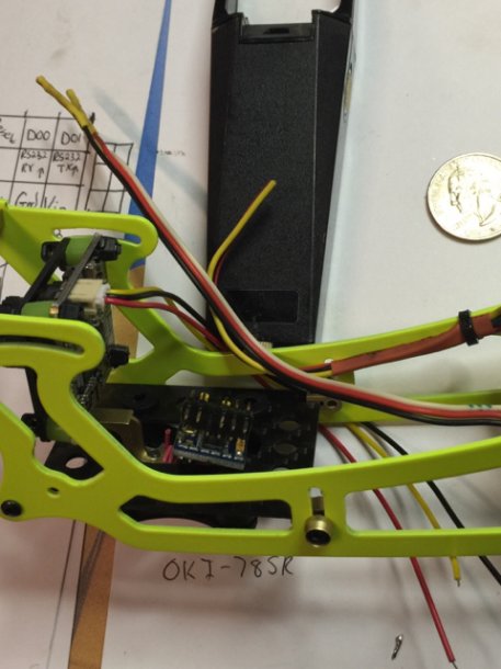

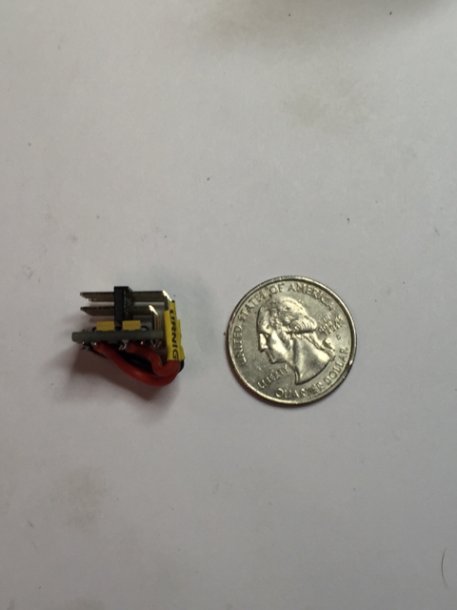

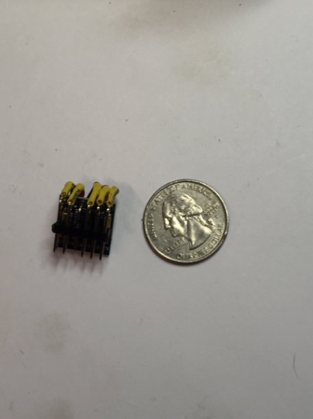

Right now I'm using the mini-minimosd on a naze and gotta say it was a pain to solder up but it's a real space saver
View attachment 26858View attachment 26859
And will tuck in right by my cam and not even know it's there
I have to give credit to OscarLang's blog for the idea of pinning it out this way
